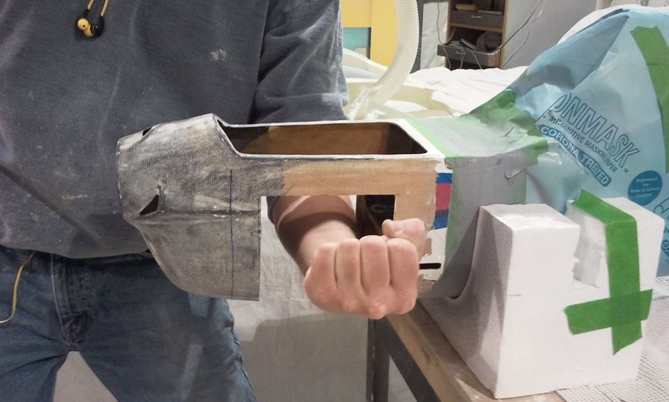

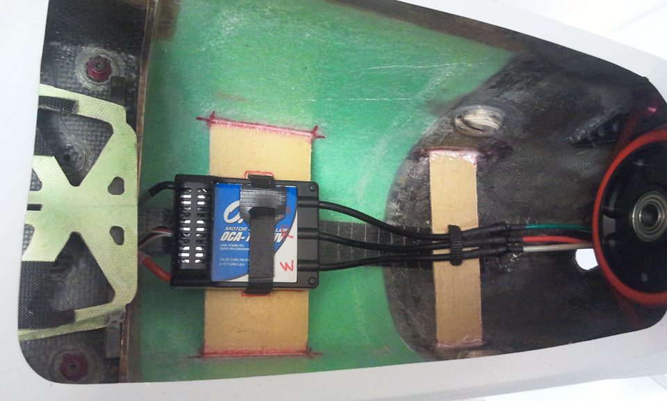

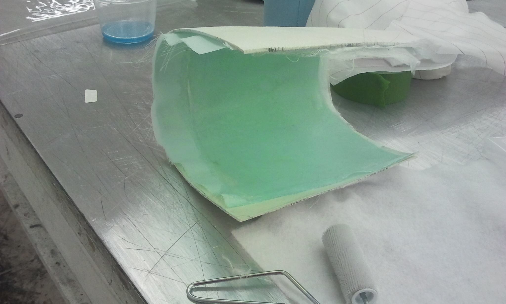

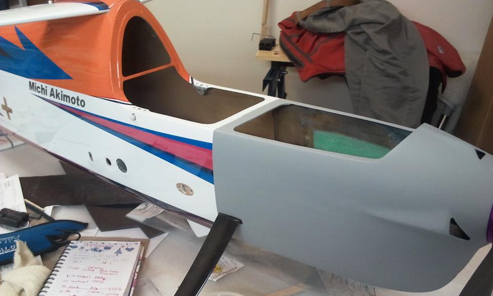

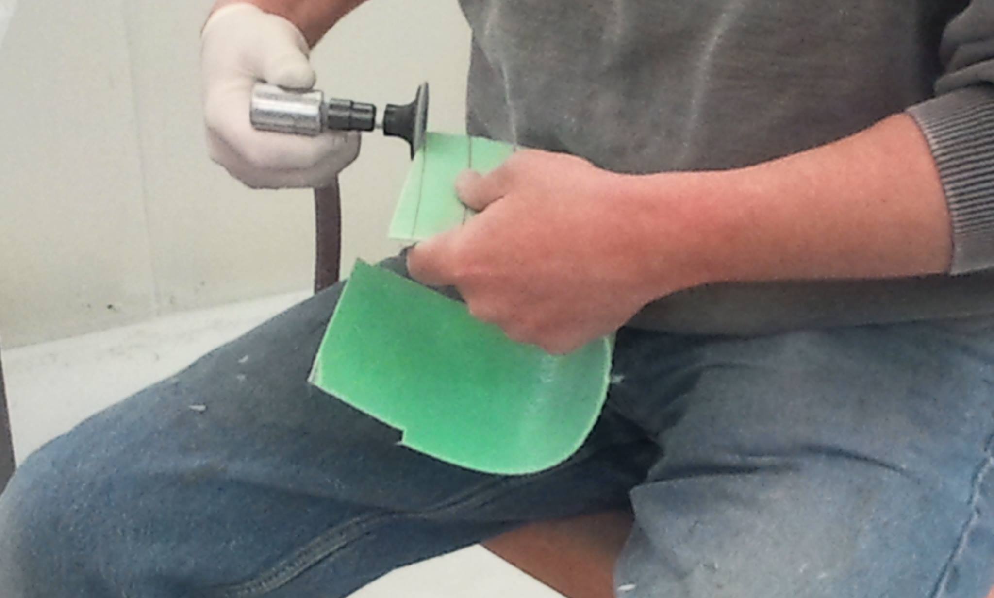

Hello John
Some pics about repair Axiome of Michi Akimoto (Team Canada F3A) :

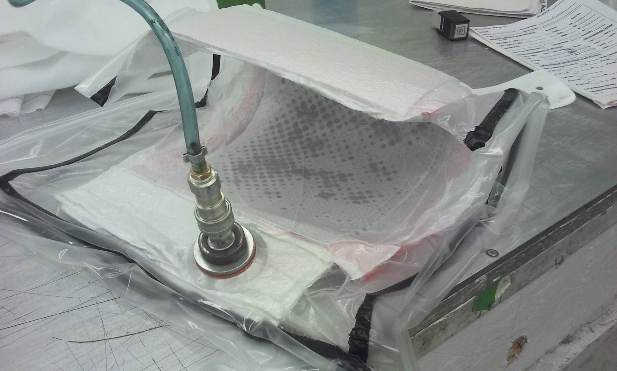

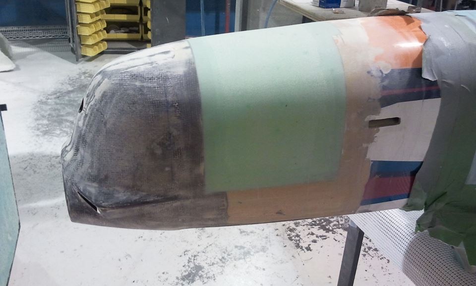

Others pics which detail repair :
Claude

I need to get one of those Vacuum Bags. Thanks for the extra pictures
It helps to have access to a professional composites shop. Right down to the manufacturing ID stamp to properly document resin shelf life, lot number and such.
Old 11-09-2014 | 02:58 PM
Anthony-RCU's Avatar
Posts: 630
From: Ossining, NY
I haven't tried it but many have used the food storage systems for small parts.
Food storage systems for small parts is an interesting idea.
I came up with the idea to apply it to model construction many years ago. It is a good set-up for some things but is somewhat limited; not as good as a full vacuum, controllable set up as Claude showed earlier in the thread. A food processor vacuum has less vacuum power than a commercial vacuum pump set-up (various sources).
Nevertheless, vacuum set-ups and techniques are great tools to have at your disposal and are worth learning.
