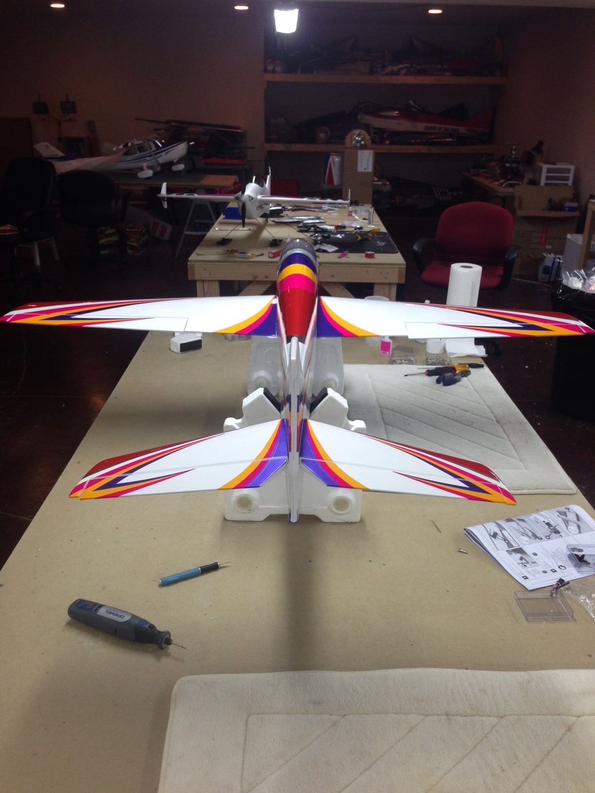

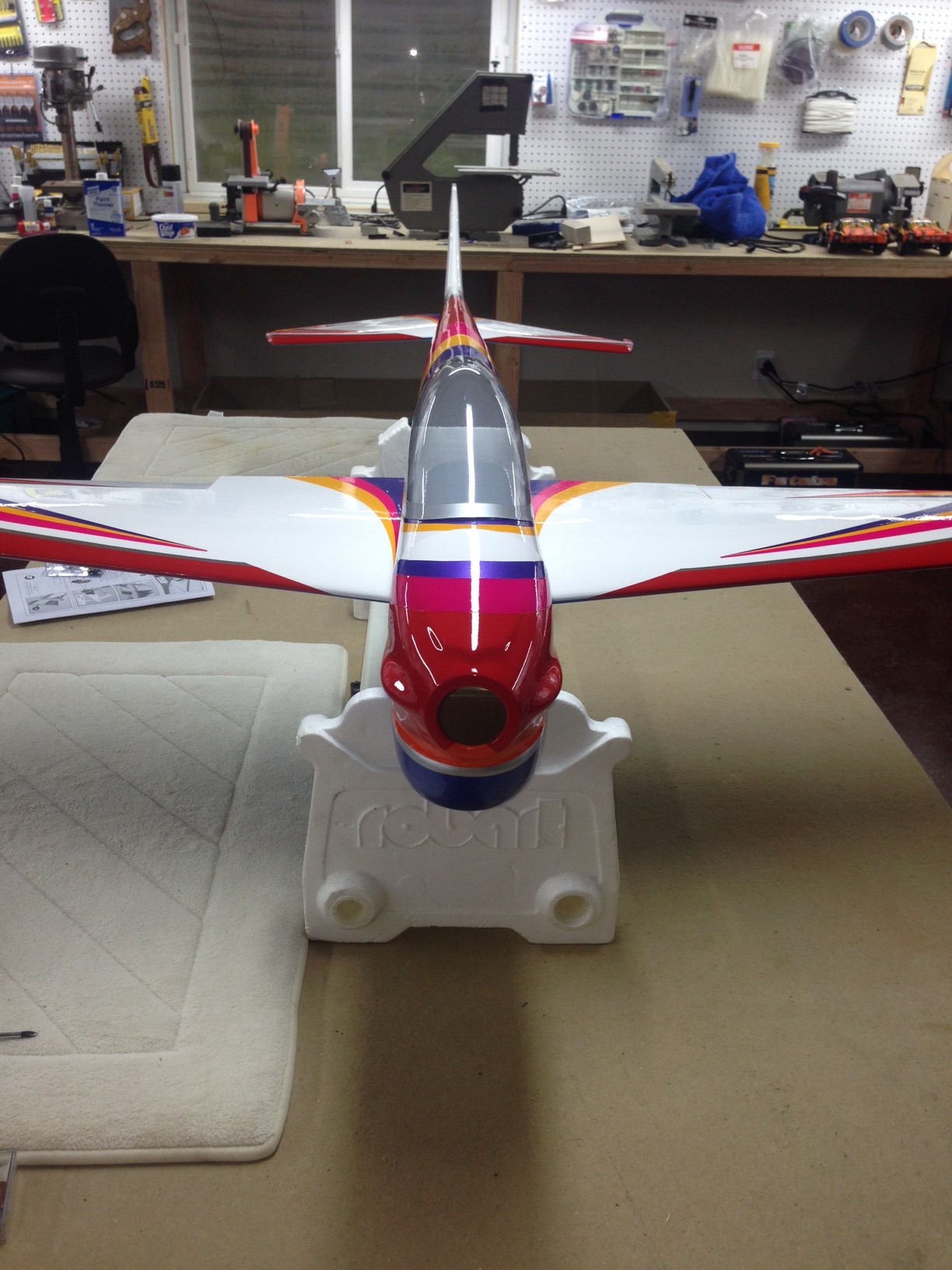

Very nice, Dan. Seems to be a version of Naruke's Asyuler 70, more or less. Should fly great, I'm looking forward to your flight report!

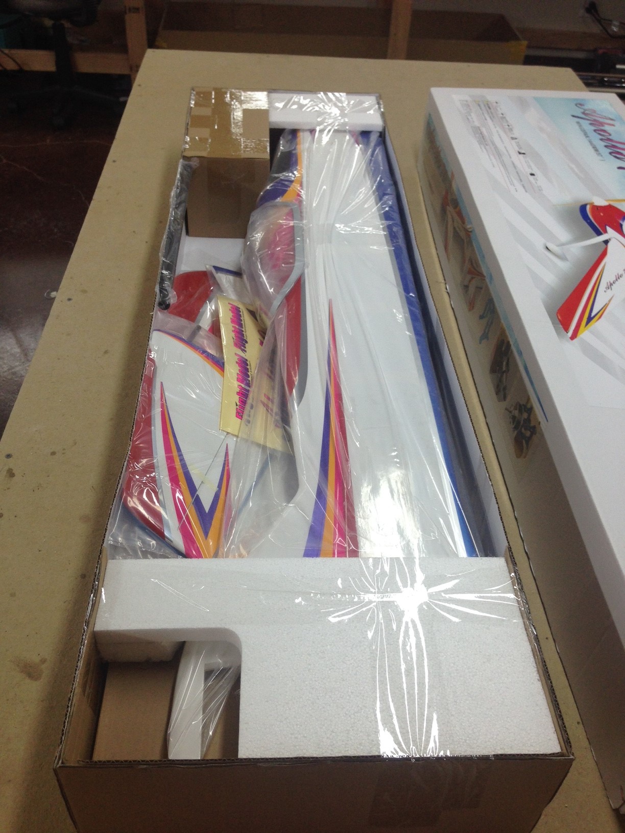

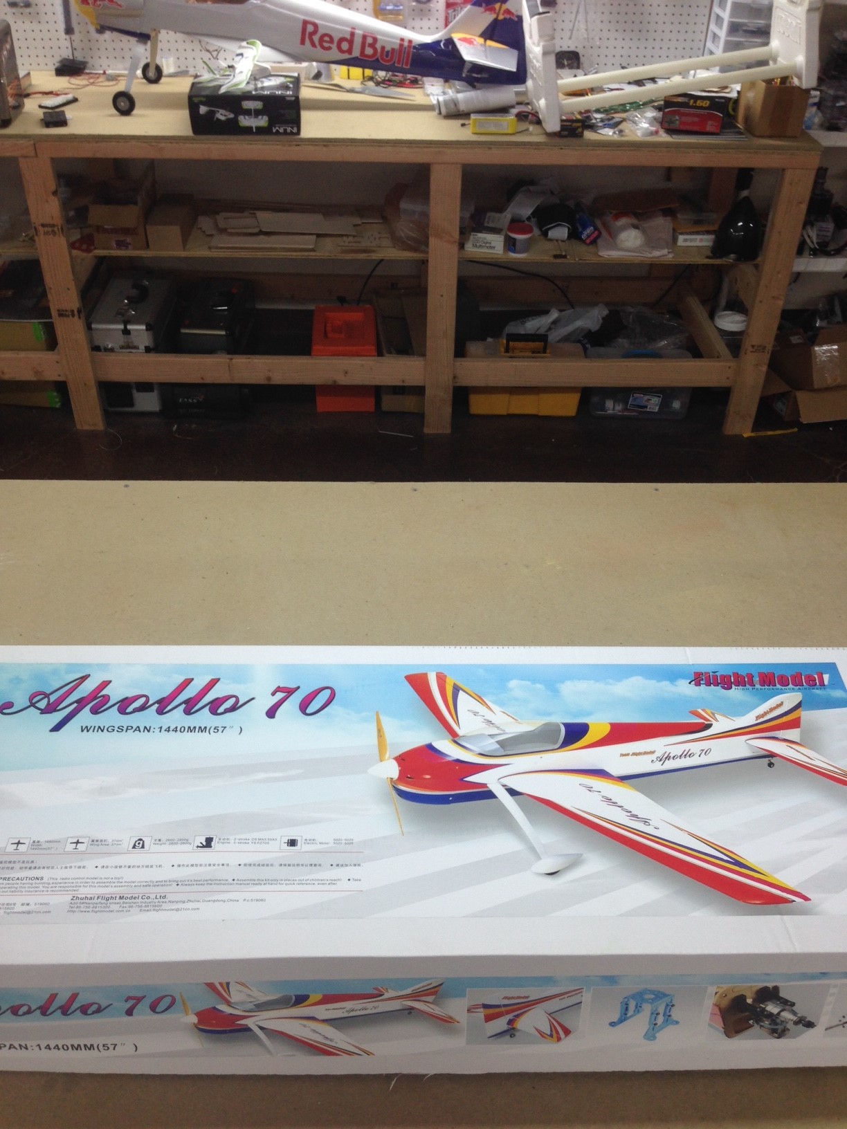

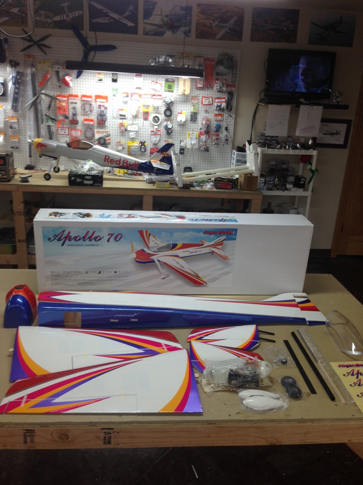

Ok, I couldn't wait. Received mine today, the Apollo 70.
The backstory: I've been flying the FMS Olympus for awhile, and I really love it. It's made of EPO foam, which has been great, but I found myself wondering how well this same design would do as a stiffer airframe. Enter the Axiome 70 by Winner Models. The Olympus is a copy of the Axiome (in outline), and pretty much the same size as the 70 version. If anything, the Axiome 70 should fly better than the Olympus since it's not going to bend and twist in turbulent conditions like the Olympus surely does. Don't get me wrong, the Olympus does great, I would just think that the stiff construction of the Axiome 70 should make a noticeable difference in this regard. I was ready to pull the trigger on the Axiome, then saw the Apollo 70. Overall, it's almost identical in size to the Axiome, an inch longer wingspan and about 1.5 inches longer. It's a near copy of the Asyuler by Japan's Giichi Naruke. I've always loved the pattern designs out of Japan, and I really like the looks of the Asyuler and it's later rendition the Acuracy. Swayed by the fact that Tower Hobbies had a $70 coupon code and that I had a nice gift certificate sitting here from Christmas, I went with the Apollo 70.

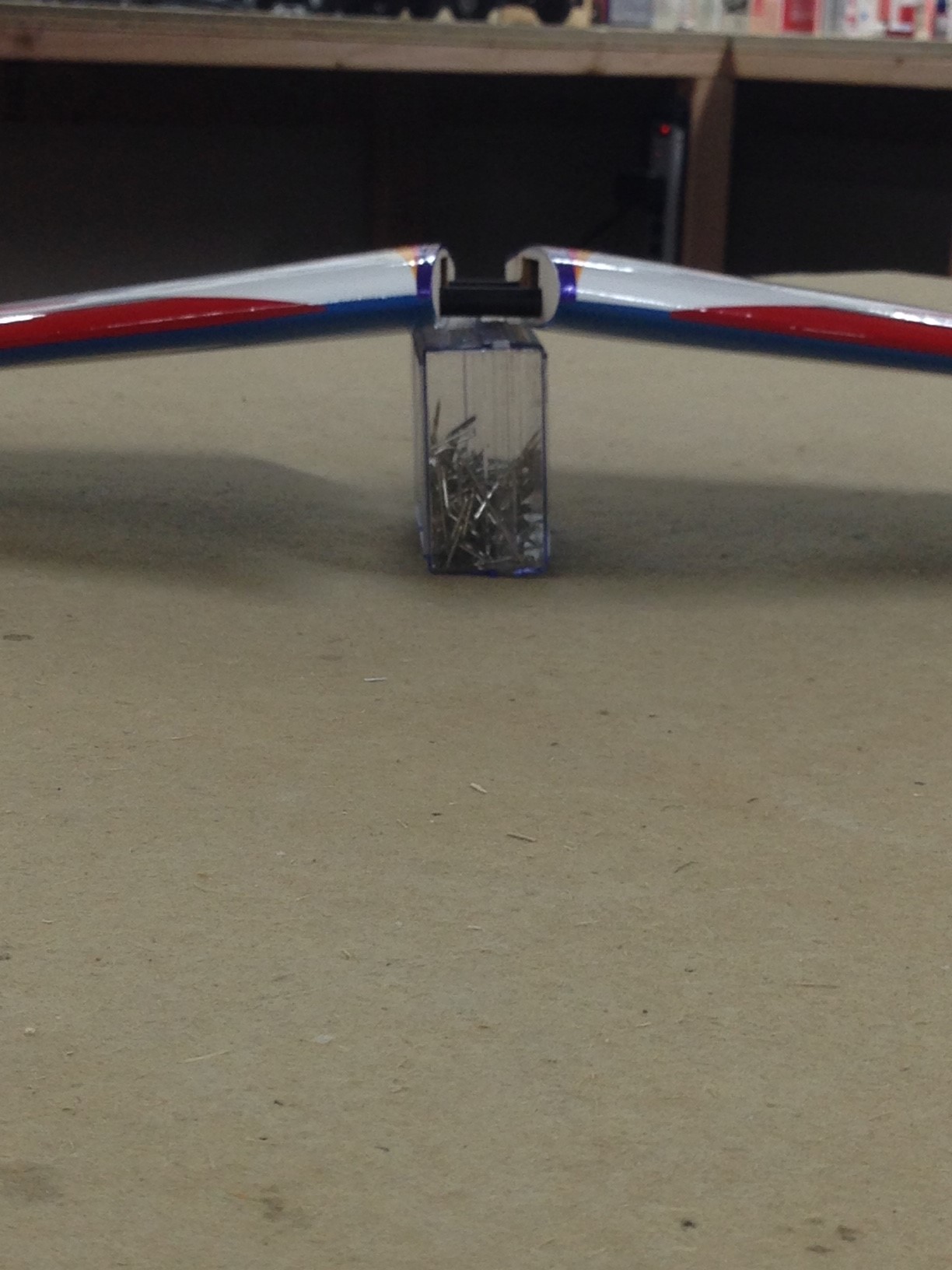

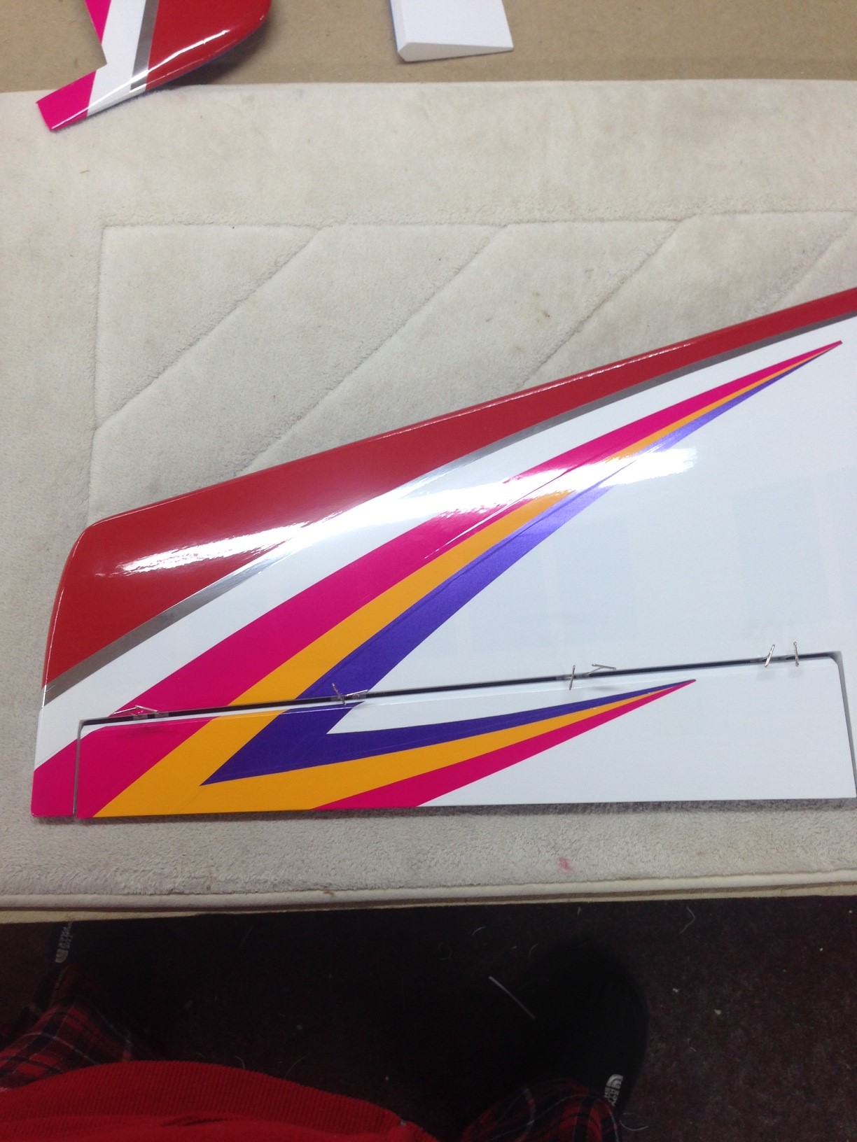

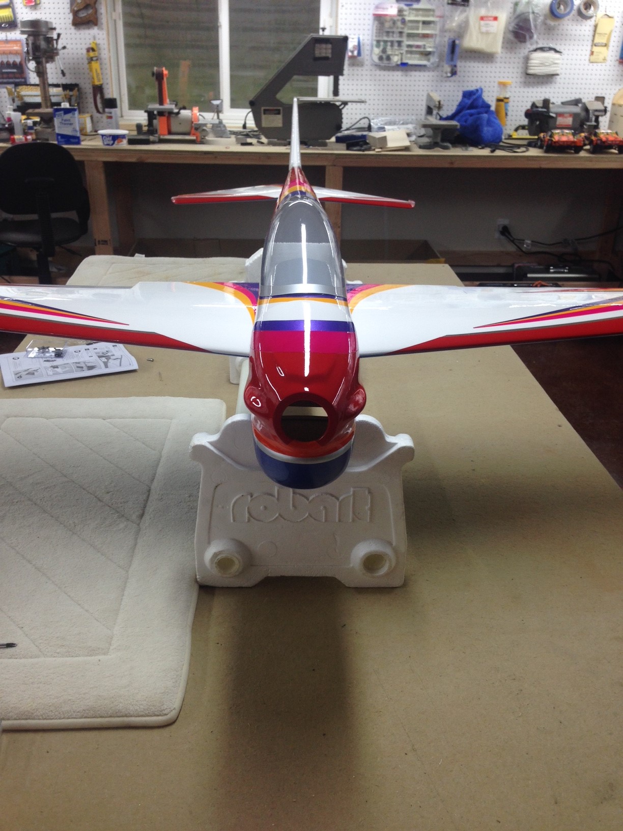

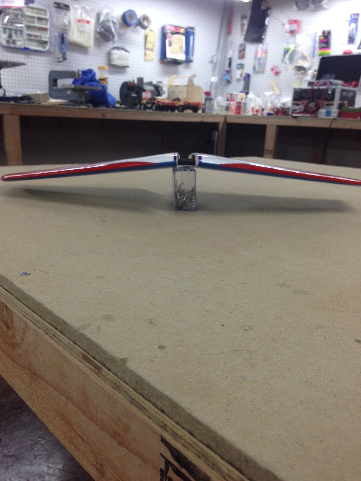

In the Apollo series, the 50 and 70 are very similar in planform, and the 90 looks to be more "skinny" in the fuselage/nose. The 50 and 90 share the same style of construction... one piece wing (glued together with plywood wing joiner) with belly pan. The 50 has a non-airfoiled stabilizer, the 70 and 90 are airfoiled. The 70 is the one that follows typical modern pattern aircraft in that it has a two-piece plug in wing and a two-piece stabilizer that has two joiner tubes/spars. The stabilizer has anhedral like the original Asyuler, whereas the 50 does not. A nice feature to me is that the wing panels butt up to the side of the fuselage, there's no slight recess in the fuselage for the wing root. It'll be easy to add incidence adjusters later if there's a need to. The construction is fantastic, as well as the covering job...really nice. You may notice that Tower's description says that it's covered in a "High quality self adhesive film". I was initially worried about that, as I saw that part after I ordered the plane. I was afraid it was going to be that sticky back cheap film. No worries though, the covering is in fact a very nice iron-on film. Wrinkling was almost non-existant, only a couple of tiny spots on the fuselage. None on the wings or tail. The colors are nice too... the purple and blue portions are metallic, giving it a nicer look. Everything appears to be straight and true. The ailerons are built up and fully sheeted, as well as the stabilizer halves and elevators. The mid and fwd sections of the fuselage are sheeted too. I'm looking forward to the "build".
