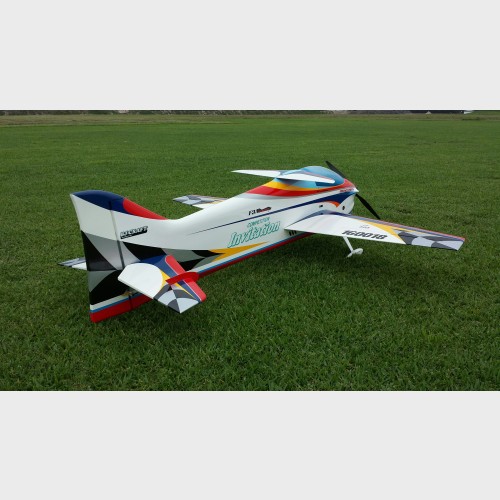

Hey guys I have a few of these:
http://www.f3aunlimited.com/bj-craft...itation-custom
They have an Akiba scheme which normally is a $300 upcharge but there was a mistake at the factory and they have an Essence sticker on them.
We've sold a few of these already and nobody seems to care as the planes are very similar.
Also to let you know. We can install the motors into these planes for a nominal fee.
This plane would lend itself very well to a Contra unit as the large fuse and wing design as well as the fixed stab would be an ideal match.
Thanks for your interest in these planes. We are getting very positive feedback on them.
Have a great and Happy Holiday season.
Mike Mueller
F3AUnlimited.com 800 591 2875
Note the picture shown is not the Oppsie plane as it shows the proper decal and a flying stab. The ones we have are fixed stab two elevators like the standard model.
