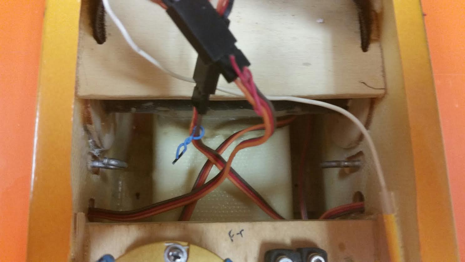

I picked up a Sam Turner designed Saturn in april and am finally going to fly her this weekend. I'm just wondering if the method of securing the wings is enough. It has a small hook screwed into each wing half so I assume this is for a #64 rubber band to hold them together. Just wondering on a plane of this size and complexity, if this is all it needs. Thanks for the help.

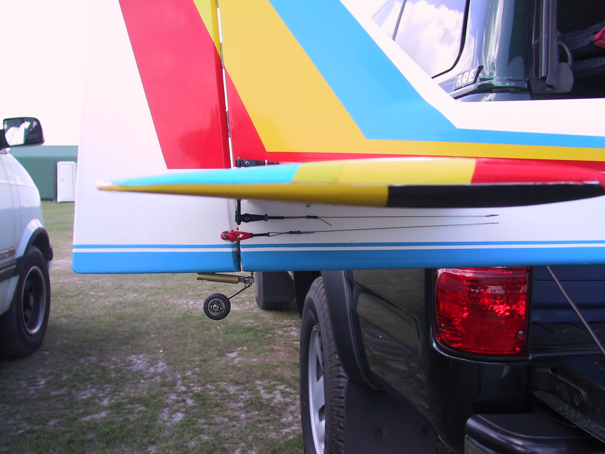

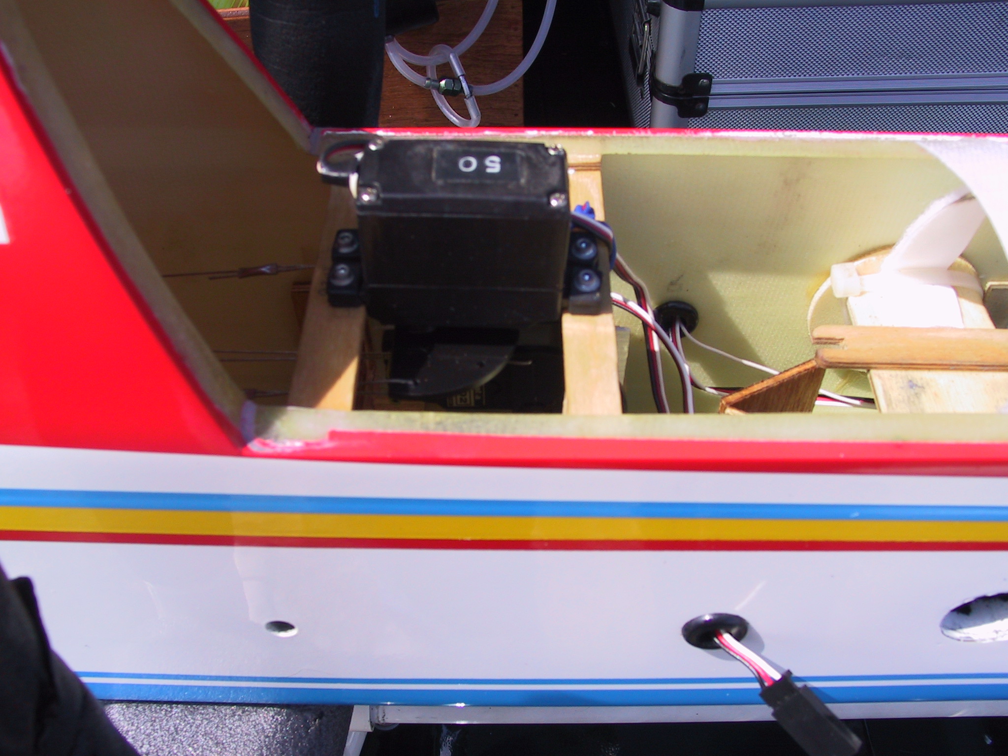

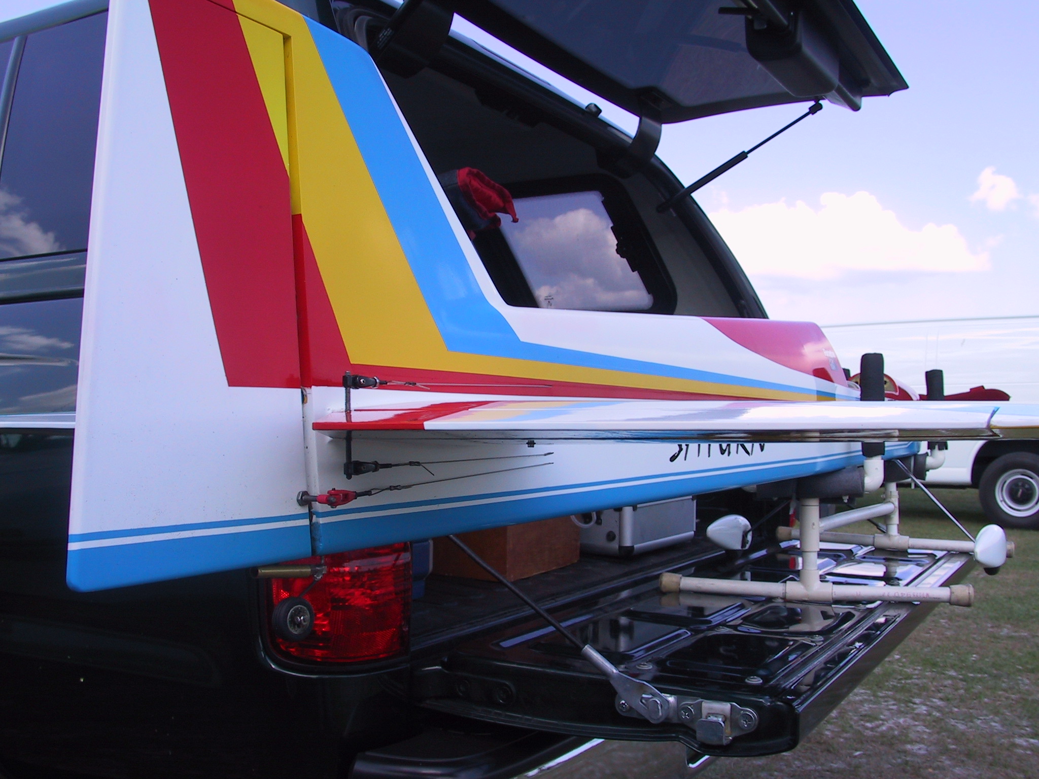

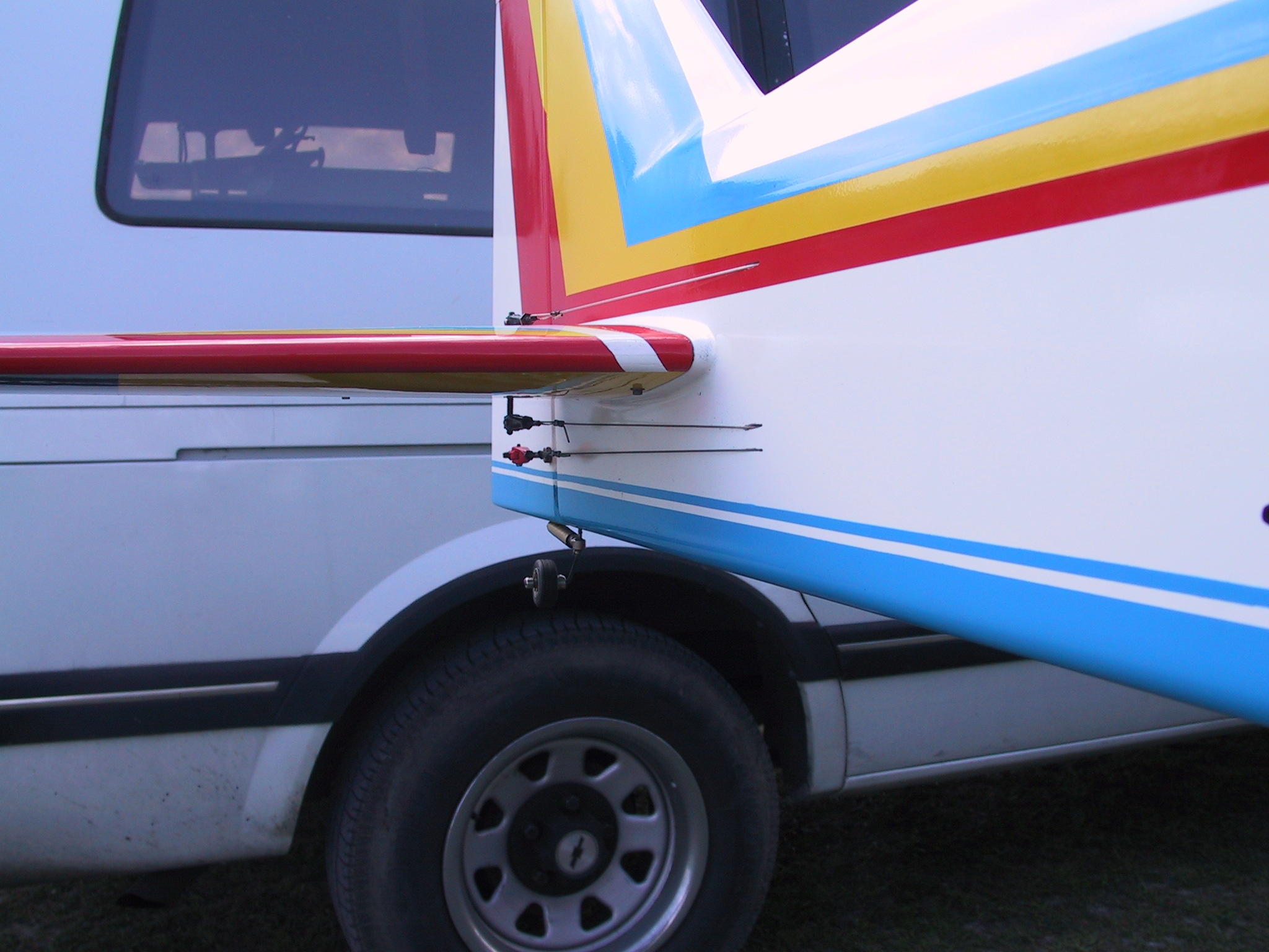

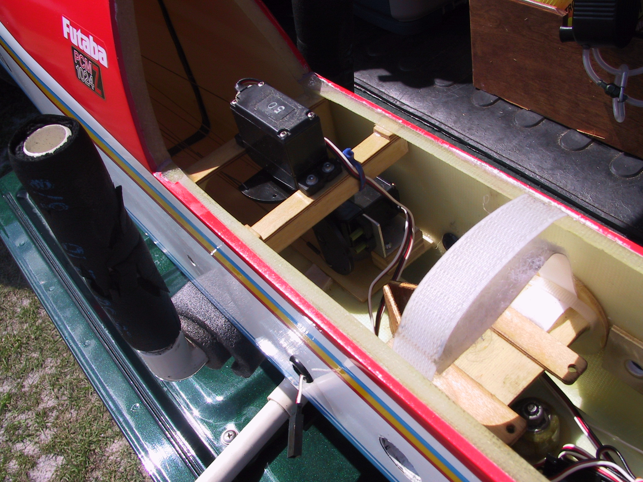

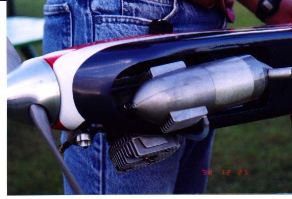

Sounds like pretty standard for the time and suggests that one was built by Sam himself. There's really not a lot of stress there, so rubber bands are fine. I'm attaching some Saturn pictures for reference. Some are detail shots of the one that ended up with the late Al Weir. I can see that I used a 1/4-20 bolt from the fuselage inside through the wing end plate. The other photos of the Saturn with the Supertigre are of one of the prototypes I flew in team selection.

As Ron sez, a rubber band is fine to hold the wings in place. Most of the load is on the tube. The plastic bolts are overkill but are also light and easy to thread. I tested strength of one 1/4-20 bolt many years ago now. It held about 75 lbs to initial yield point and never did break clean as I recall. It simply stretched to about 110 lbs pull when I stopped the tensile test.

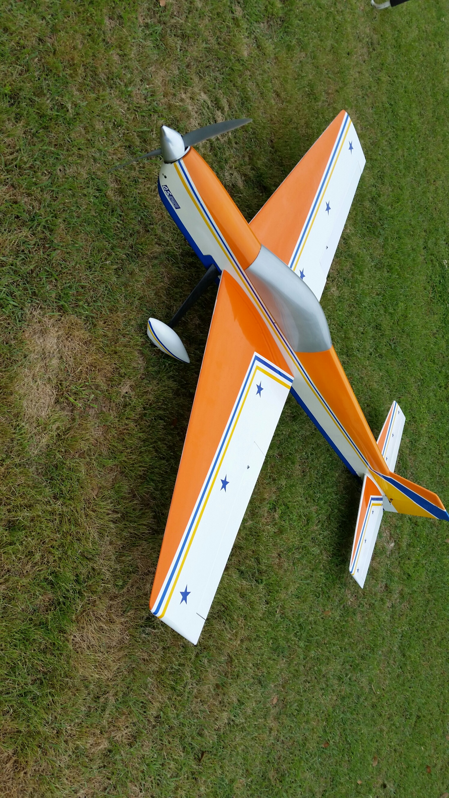

picture of mine

Flying it for the first time this weekend.

Let me suggest that you cut the band you need from a bicycle inner tube. Just long enough; lasts a really long time
