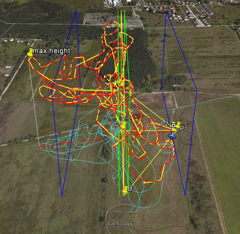

Here's a demo fly path recorded with RCFA. It includes GPS Logger (red line), Real-time record (yellow line), Flight Area (rectangles). It is a free flight as I'm not a F3A pilot (yet - maybe). It is easy to calculate radio range which was about 450 meters in this case with about 95-99% packets received. Unfortunatelly it was hard to fly further because of lost of sight.
I'll send above kml on demand as a replay to order form at www.littlecircuit.com/order

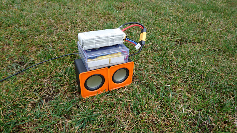

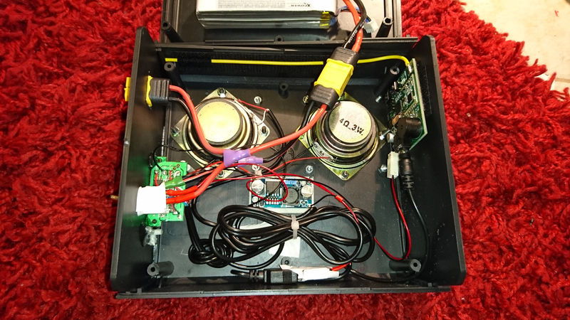

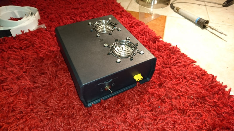

I'm glad that one of RCFA's users has mounted a nice "beeper-station Well done on that

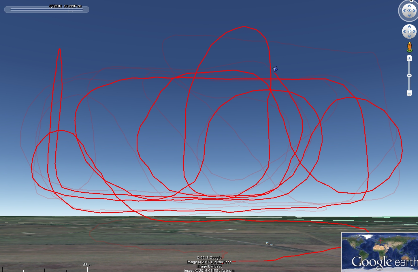

Hi Arek,
I'm still surprised how many errors can be seen by analyzing the kml. RCFA is great help for me, especially because I fly alone.
Adam
