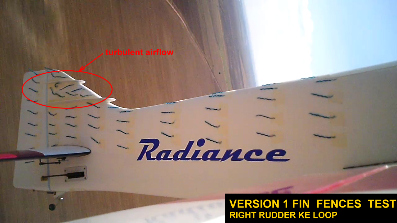

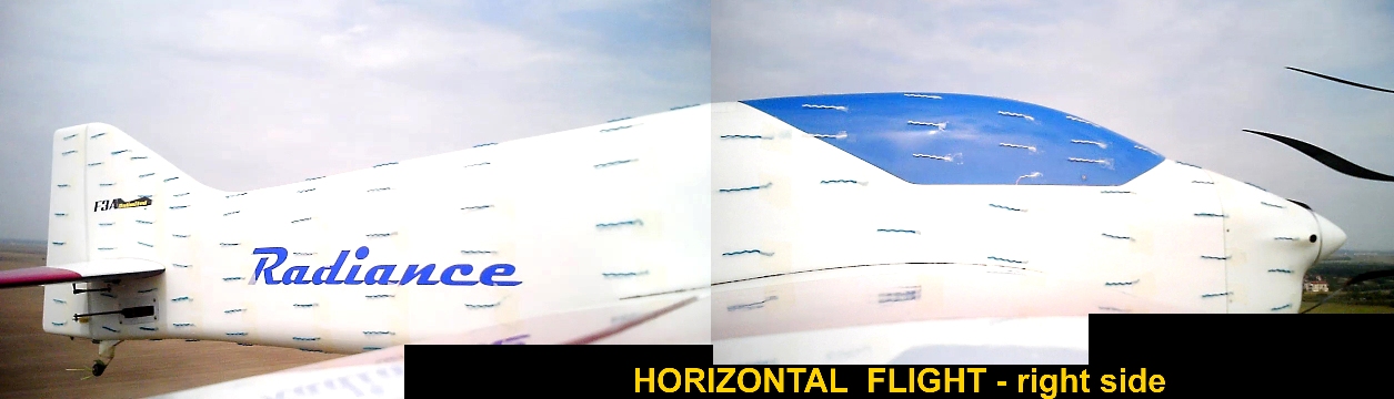

There's no massive turbulence caused by the canopy, unless the canopy is very poorly designed which is not the case for the Allure. I've seen jets designed to fly at Mach 2 with less streamlined canopies than those used on our pattern planes. If there's any turbulent flow, it's mostly caused by the spinning propeller and not by the canopy.
I think the tufts in the videos are way too long and may give you the wrong impression about the amount of turbulent airflow around the plane.
You can try moving the tufts elsewhere on the airframe and if you keep the same length i'm pretty sure you will get the same results. It doesn't mean the canopy or other parts are causing turbulence.
If the tufts are short, they will align themselves with the local airflow without shaking too much:
If there's any turbulent airflow, the tufts will show it even if they are cut short :
ID:	2189987   Click image for larger version
