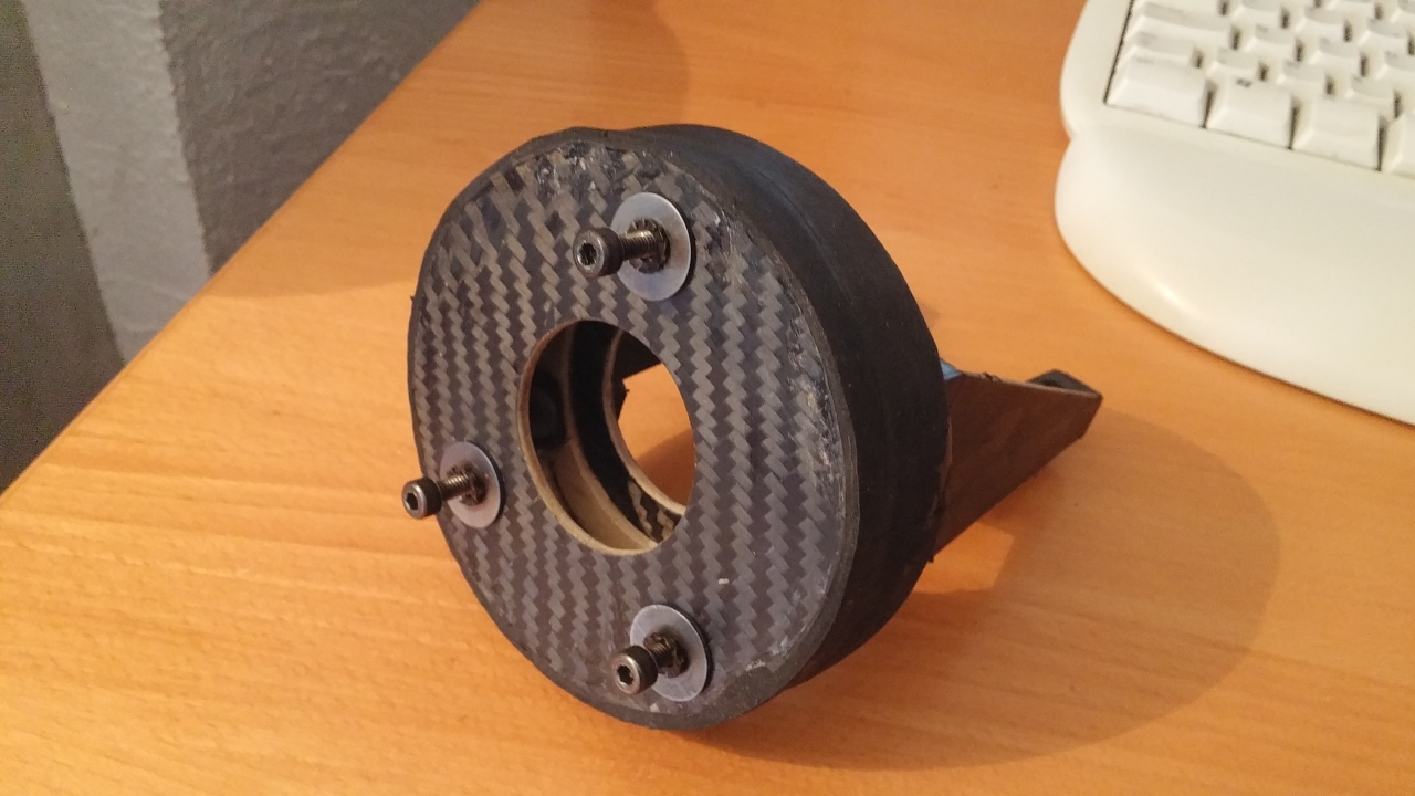

Claude what kind of engine mount are you using.....
Please report on the YS 200 ...
regards

Hello Con
I used a flex mount I built myself.
There 2 layers of rubber (scooter inner tube)
Claude

Very clever Claude...

Hello
I forgotten, it is necessary to have a front ring.
claude
