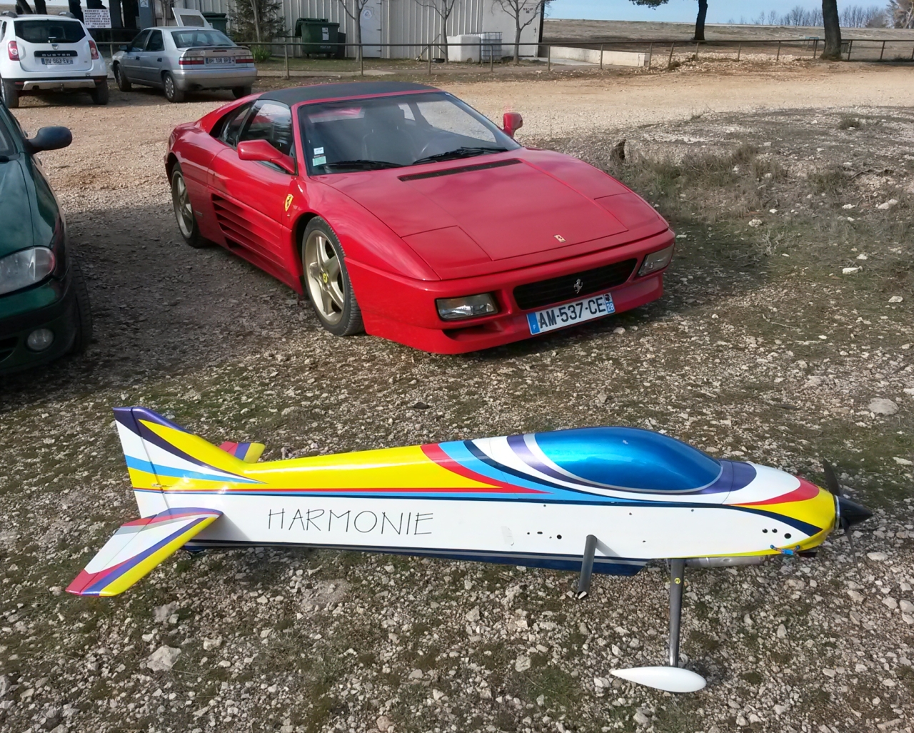

#75
Hello
Thanks for sharing informations
6 flights (about 13 mn per flight) with YS 200CDI. I Dont know maximum rpm but it is not important because torque is very strong.
Flight is very constant speed.
Claude
NB : Ferrari is not mine , I have a Yamada !
