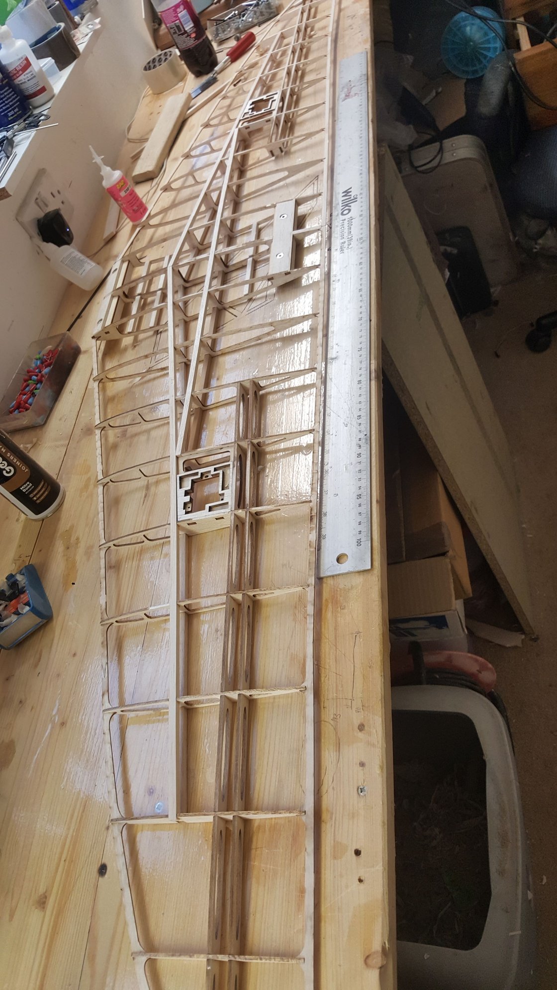

Some pics of the early stages of my new build. Based on my last monoplane, but with 2 wings.

Very impressive! The structure looks quite light weight. Did you do your own laser cutting or outsource it?

No i draw it then send it to Belair (uk) to have it cut. Would love a laser cutter but money and space wont allow 😀
Getting on with sheeting now, done the easy bit. Just got to deal with the planking.

Very nice work. What thickness sheeting for the fuse...same for wings/stabs?

Thanks Mark. 3/32 all round on this, not gone for contest grade this time, for cost reasons. These sheets are coming out about 21g for a 36"x4" sheet.
Couple of pics of the motor mounting. I've designed in a shroud to try and help with cooling. I know these motors can run a bit warm!!

Fuselage is pretty much complete now. Just the rudder to cut out and face.
Planking the bottom of the nose was very time consuming, each piece had to be shaped and soaked to bend up to the nose ring. Also aliphatic meant only 2 strips at once. Worth it though, even with a rough sand its come up nice.
Happy with weight, its 880g at the moment with the canopy, so prob be about 900 when its cut out and hinged. So its about 20g lighter than the old one, without using contest grade balsa

So the airframe is pretty much ready to cover now, hoped to have had it flying for the next comp but that seems unlikely now. Small things like checking the wings are square seem to take ages, especially when you cant put it together easily in your shed! Cutting ailerons out was also a pain, mainly because theres 4.
Not too many pics of the wings, but heres the ones i took.

The wing structure was glued to the bottom sheeting as a whole, then each half had the top sheeting glued on seperatley. I used a jig top and bottom, weighed down, which i've done with all my wings. As long as the bench is flat, so should the wing.

Realy nice looking. What is the engine trust angle?

So it been built with 2.5° right thrust and 0 down thrust. I trim my models out gravity neutral so i expect the down thrust will only need a little tweaking to hold a vertical up line.
Right thrust was just a guess really and may need moving a lot, it might not.

Got it finished and flying this weekend. Had 4 flights with it yesterday, even managed a p19 with it on the last flight.
Very pleased with it so far, bit of work to do with it re rudder trim but apart from that its great.
As with most biplanes, rudder is very powerful making rollers and ke manoeuvres a lot more stable and easier to control. Problem is the powerful rudder control it amplifies any unwanted yaw trim.
