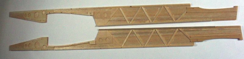

I obtained my kit from Pro Build in the U.K. along with most of the bits and pieces to bolt on.
Initial impression is of a lot of bits for the fuselage but it seems to be working out fine after completing the side sub assemley. Photo shortly.
I am sticking with the M.K. Mount for speed rather than change things. If it gives problems we will just build another fuse. The first Team Trial event in the U.K. is towards the end of April so I need to move on this one to get some stick time on before this event.

We did think about the YS Mount but decided to stick with what was shown on the drawings. I hope we can live with this decision. We can always machine some different rubbers using material we have used in the past on the Dave Brown Mount which seemed O.K. The construction is now at a stage that it is too late without some major hacking at the front end.
Anyway here is a pic. of the main side sub assemblies, must be almost half the fuse build time in this lot.
