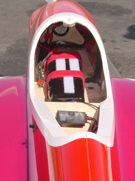

Hi all,
We have finished the Rev-Pro just in time for this past weekends pattern contest here in Phoenix. Sean Plummer and I worked on the plane all last week, while sick, adding to the "excitement" of finishing the plane for the weekend.
Here are the specs:
Airplane: Composite-ARF Revolution-Pro
Weight: 10 lb 13 oz
Motor: Hacker C-50 14XL Acro 6.7:1
Controller: Master 77 3P Opto
Batteries: Thunder Power 6100 10S3P HD (prototype pack)
Radio: Futaba 9ZAP
Servos: Ail: 9252's, Elv: 9650's, Rud: 9151
Prop: APC-E 22x12
Rx battery: Duralite 1900 2S2P Li-Ion with 6V regulator
Everything was mostly stock. The firewall and landing gear/parts were not glued in per my request. I had changed them a bit for the Hacker set-up. The landing gear was mounted further down in the belly pan area rather than in the fuselage. We did eliminate 1 former for the landing gear, but it was "replaced" by the battery floor. It still needs a slightly taller gear as I only have about 3/4" prop clearance. We used the same nose ring assembly as in the Rhapsody, but had to make a smaller rear mount. I mounted the 9650's in the stabs instead of the 1 servo under the canopy area. The Rx pack was at the rear of the canopy, with the rudder servo. The TP pack was also mounted up against the wing tube to help get the CG in the correct position.
The plane weighs 10 lb 13 oz, with no unnecessary modifications. This is about a 6-ounce heavier set-up than what the Rhapsody was. The batteries (High-Discharge over regular) are 3 ounces heavier and the motor (C instead of B) is 3 ounces heavier. I also am using a Tru-Turn spinner instead of the stock carbon one, which is about an ounce. So I could have it down to 10 lb 6 oz if I wanted to, but the way it flies...there is no need.
I have a total of 8 flights on it now, counting the contest flights. It has no aileron mix and 5% and 2% rudder/elevator mix. I still have to do somemore set-up with it to get it "perfect", but it's fairly close right now.
Here are a couple of pics, courtesy of Kyle Mashima. The 1st one shows the plane together. The 2nd is a forward looking shot showing the battery and motor area.

The Hacker website will be going through some revamping in the coming weeks. We are working on getting the application chart up for the C-50 series in the meantime.
Comp-ARF now has the former templates that we made while putting the Rev-Pro together. I don't know when they will offer the E-version, but I would imagine with-in 2 months. They are releasing a bunch of planes at this time so this is where it falls in line. Don't know the life of a Hacker, but the one in the Funtana flown at the 2002 TOC is still flying on its original set-up. If you treat it well, it will treat you well. The new batteries are going to be available with-in a month or 2 if I remember correctly.
I had flown the 8A batteries, but only before the competition. I could not make weight with them, that is why we used the 6A ones. I only flew 10 minutes or less because I knew that I was pushing the limits on the batteries running this set-up. I did fly a few 12-minute flights, and everything was fine, but I didn't have a need for many of those long of flights. I never did have any problems with any of the packs (8A or 6A packs) while I was at the Worlds. I did "weaken" a Worlds pack a couple of weeks ago. We were testing the Funtana and I shouldn't have flown it soo long and I think I ruined a pack. Expensive lesson learned.
The model is heavy by electric pattern plane standards. Remember though, this is a glow plane that was converted. The E-Factor is a great e-pattern design, but the original is not a competitive F3A machine. I have not seen or flown the new version so can't comment on it.
As for the battery questions, I would ask Charlie at TP about that. I don't know enough about it to comment on it. I know that in my F3A rounds, I was using anywhere from 4200-4400mAh each time. We had talked about trying a 2P pack, until we remembered what we were using each round.
