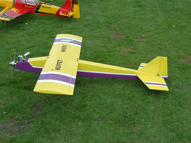

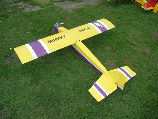

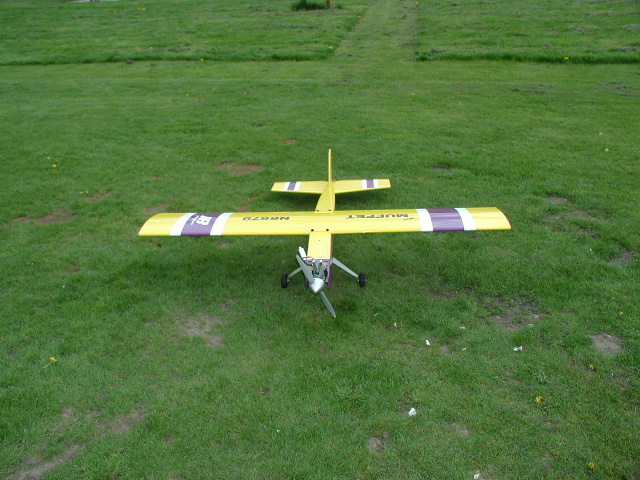

For all that are interested, I've uploaded some shots of my Miss Muffet. I designed the Muffet around '95, and bunches of them are still flying and being built here in the Pacific Northwest. I let Gus have the design for the Salient catalog, and now that I own the business, I've got the Muffet back. FYI, Muffet is an acronym that stands for Multi Use Fun Flying and Educational Tool. The one in the pics is the original .60 size (900sq. in.), with a Saito .91 aboard. Muffets will do amazing things, and are both very aerobatic and rock-stable, depending on dihedral and radio set-up. They make great trainers (that won't bore you to death while your student learns to fly), and great float planes. They've been used for camera work, aero-towing, and Sportsman Pattern. They use the same basic NACA Series 6 airfoil as the Boxer series (and the original Cursor, Meridian, Python, and Olympian), but are made semi-symetrical by the addition of a 2% mean camber line. They use the original Cursor nose and tail moments.
