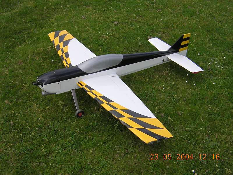

I've finally finished my Widebody 60 and have just made a couple of flights. I installed an OS 90FX with an APC 13x8 and have noticed that in striaght climbs it isn't as powerful as I should have expcected. I thinking of several solutions, or combination of them.
- Change the propeller to a 13x7 or 14x7. Any recomdendation on the propeller size?
- Install a pump. I had thought of a perry oscilating pump. Which type would be the most apropriate?
- Change the carburetor. I had also thought of a perry carburetor. This change is due to the slow responde the motor has. It takes quite a while before it gets to its top rpm. Which carburetor is the best?
I hope someone has some experience with this changes and is capable of telling me which is the best. I haven't thought of changing the muffler, basicly becuase it would mean major changes in my airplane.

Hi!
i have one installed in a design off O.Fremming from Norway its light but have no problem with performance or the engine what so ever!
i use a apc 14 x 8 a pipe i don't know what type is and the plane weigh ca 3,4 kg u can launch the plane vertical!
the engine is straight out off the box ..no pump and original carburetor , i was thinking about to install a set from the Os 61 Hanno but haven't don that , after 100 flights ...not one stop in the air!
is it any other problem than the vertical performance?

Before you go to a Perry pump I suggest you check a couple of things: use a good plug - OS A5, or a No.8; make sure the tank outlet is is positioned level with the carb spray bar. Also use 15% nitro if you can. A mouse can muffler is fine for a Funfly but for a Pattern Plane like a Wide Body 60 you might do better with a Macs Muffler (the OS 61FX fits the 91). Better still go with an "S" header (manifold) and a Hatori type pipe from Just Engines in the UK. But check the tank position first.

I'm using an OS No.8 Plug and a 10% nitro. During the construction I really made an effort to try o have the tank's outlet leveled with the carb spray bar, and I finally did, but even though the engine seems to lose some rpm when it is in a vertical climb. I installed a glow charge valve and think it might have something to do.
I have also noticed that using a Master Airscrew or an APC makes a great difference.
Before trying to put a muffler with all the modifications involved in it I thought a perry pump would be a cheaper and easier solution.

CEV are you flying at altitude?
The reason I ask is that I am flying a CZ models rebelove 6lbs10oz on a 14/8 spinning at 9800rpm on a standerd exhaust and 10500 on a pipe with 10%nitro 18% oil and an enya 3...this combo is simply balistic

How much your widebody weighs? I am using a 91 FX on my K-trick 90 which weighs about 3600 grams. With straight 80/20 non nitro fuel I hand launch it vertically 90 degrees and it goes vertically unlimited.I am using APC 14x6, coz I prefer low pitch for better vertical. no problem with the carb.
Are your fuel lines too long or there are multiple bends of fuel line which can cause head loss of pressure? check your fuel tank also.

IT IS THE PROPELLER!!!!!! Change the flat paddle to a real prop.....In my experience MA props bends and twist under load. They surely rev up, but the lack in the thrust department. I would only used it in a trainer.

I actually fly on the top of a moutain 600 m abobe sea level. The final weight of the airplane is 3,5 kg. I'm now using a Master Airscrew because the landing strip is full o tiny stones that break off the tip. In my fisrt flights I used a APC prop and it went much better. I think that using an APC 14x6 or 14x7 will make a big difference, I'm sure of that. In my club the Master Airscrew are well know for their bending, but we normally use them becuase they usually get choped down.
Any way I'm still thinking the pump might be a good idea. I have revised the tank-carb alingement ant tried to reduce tha number of couplings, bends, and so on to the minimum. I think that is not the problem.
I still have the problem of the carburetor response. Any suggestions?

Just take out the baffle from the stock muffler n use an APC 14x6. See the difference. No need for any hopups....If with time u dont like the vertical, u might think of putting up a tuned pipe.

I am flying a WB with an OS 91FX with a Perry carb. It is swinging an APC 14x8. At 6 pounds 8 ounces the vertical is nonstop. I don't have any RPM numbers, but I really like the combo. I am using K&B 1L glow plugs and 10% Cool Power. I fly at 600 feet above sea level.
