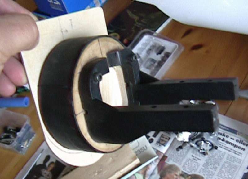

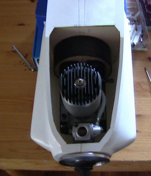

some pics!
first i added some smal pieces of ply to make it a bit stronger behind the firwall.
u can see how the drawing didnt fit. the mount i'm going to use ....and all in place with engine ..just dryfit so far. I also cut out a bit more off the engine room !

Rune, Looks like there is plenty of room up front. What engine is that?

hi!
yes its plenty place ...engine is an os 140 rx!i have moved the firewall ca 10 mm longer back than the plans say ..but yes ...no problem with the room

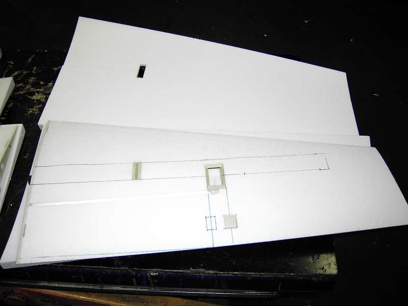

Got some work done today!
i have got the wings sheeted done some work the past weeks to get the foam cores ready for that job!
i use Casco Polyurethane glue ..don't have the stuff for vacuum and epoxy ..so does it the old fashion way!
as i don't have a table that is good enough in my home i use one at my work!
the pics talk for it selves i should think!
i used also some glass which was layed on the cores where u can see the marking from root to the tip , this glass is used here in Norway to reinforce walls in the joint for the fiber plates before painting, its a very open type .
at the top to weight it down i used over 200 kg with cu wire .
Rune

still working on it ....
have sheeted the wings ...as u see on the pics ..have got all teh hardware in the house.this days working on the tubesfor stab and wing tto get them at the right angels into the fuse...soon ready to glue them in!
so u did buy one in the end Tom!
i probaly dont fly mine until feb\march.
Rune

Could someone please tell me the width of the firewall. I read somewhere some of the drawings weren't correct.
Old 11-17-2004 | 10:38 AM
  #48
Joined: Apr 2003
Posts: 725
From: Vikersund, NORWAY
Default RE: Temptation Kit
hi!
look at post#26 and see how my firewall ended up...
sorry dont have the drawing anymore...but start whit one i cardboard or thin basla
Rune

OK thanks Rune. Is that the Ola mount you are using? If so, where are the blind nuts placed and how does it attch to the fuse?
thanks
Old 11-18-2004 | 10:34 AM
  #50
Joined: Apr 2003
Posts: 725
Hi!
the blind nuts are inside the mount, and i fasten it from inside the fuse with unbrako screws (m4) and that it also the case on the engine side.
And yes its the same type mount that Ola describe.
