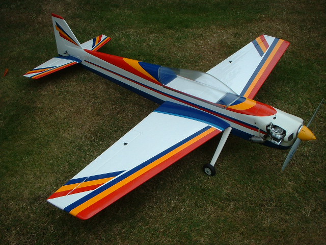

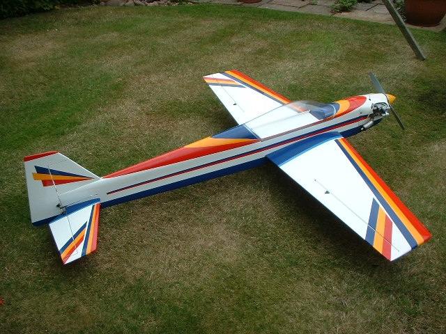

Hi Mirco.
Here are a couple of pics of Onyx (I hope), I know the purists will disapprove, but I can't stand inverted motors.
Cheers.

Old 07-15-2004 | 10:19 AM
SCJ
Posts: 153
From: Chandler, AZ
Default RE: Onyx, Saito 180 prop
I like it with the engine hanging out. And, if there is an engine problem, it's more practical as well.
Sam

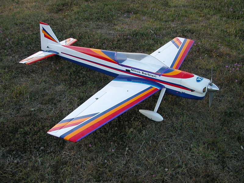

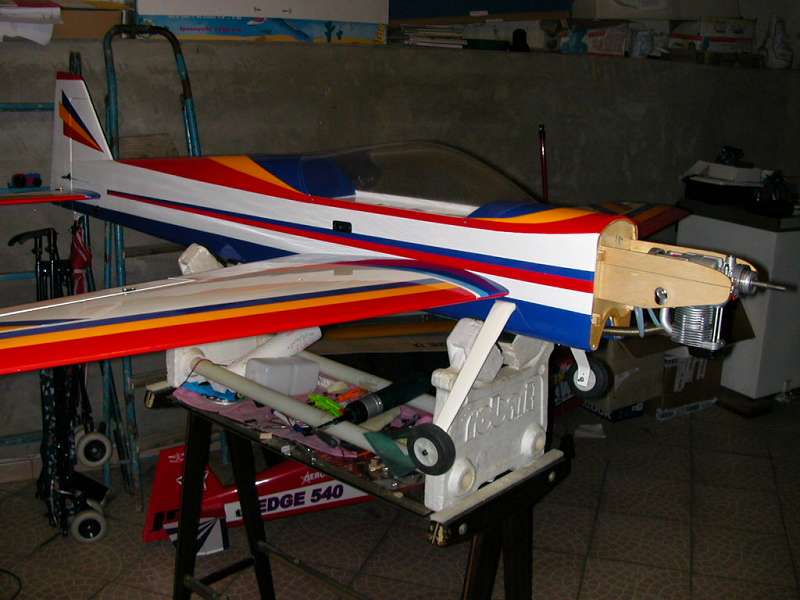

hi Futaba
this is my Onyx with a little modified engine mount in order to use YS soft mount.
Regards Mirco
