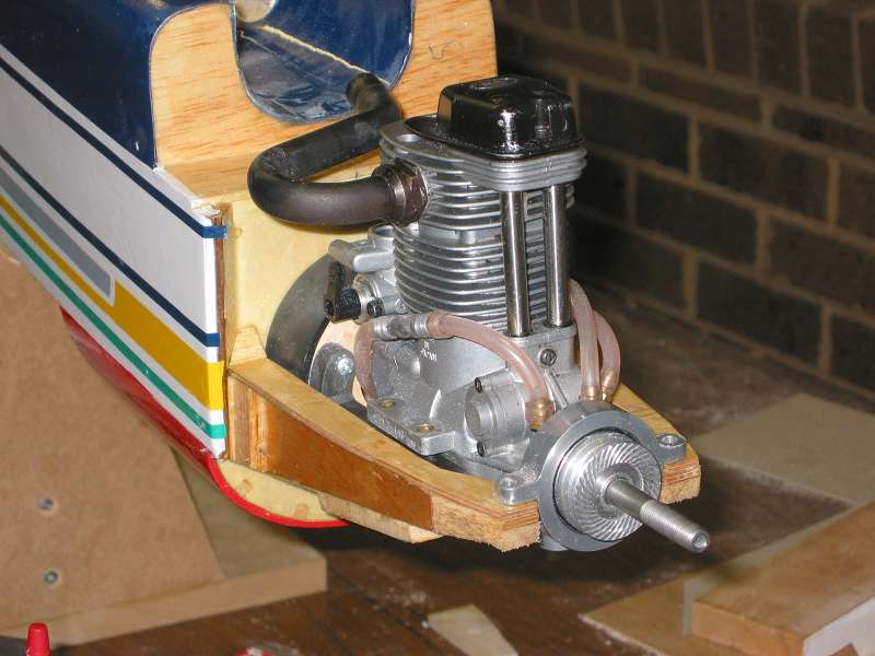

Here's what I did, to fit my YS 140L. Works very well and is very light.
Basically 1/4 inch balsa, laminated with som 1/16 ply. Then keyed into the firewall with 2 x 1/8 inch dowels on each side, with some added triangle balsa.
I installed the "hyde mount" first, in the correct place, then tack glued a couple of 1/4 balsa sticks to the nose ring crade. The sticks sat on top of the hyde mount engine bearers, ensuring it all lined up perfectly.
Here's a couple of pics.
Regards, BruceT

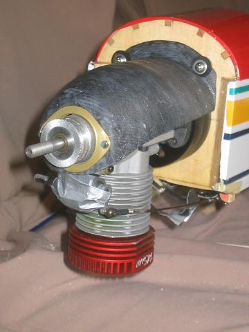

Here's my solution.
It really wasn't that much work once I figured out how to do it. The 'mold' is made out of a plastic bottle and some scrap wood. The lay up is 4 layers of glass and one layer of carbon with epoxy and some micro balloons to make the epoxy more 'past-like'.
The result is light and very rigid. I ran a few tanks already and the engine remains rock steady. Hopefully first flight this Sunday.

Great job... The only concern I would have is if there would be enough air flow over the crank.
With all the disscussion of the Webra bearing issues and keeping it cool you may want to concider making a vent at the crankcase area.
Many of us have been putting air inlets on the top part of our fuse to force air in the crank area.
