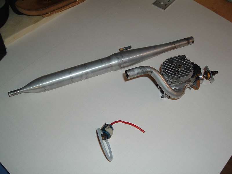

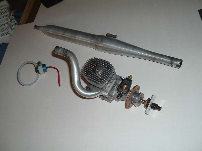

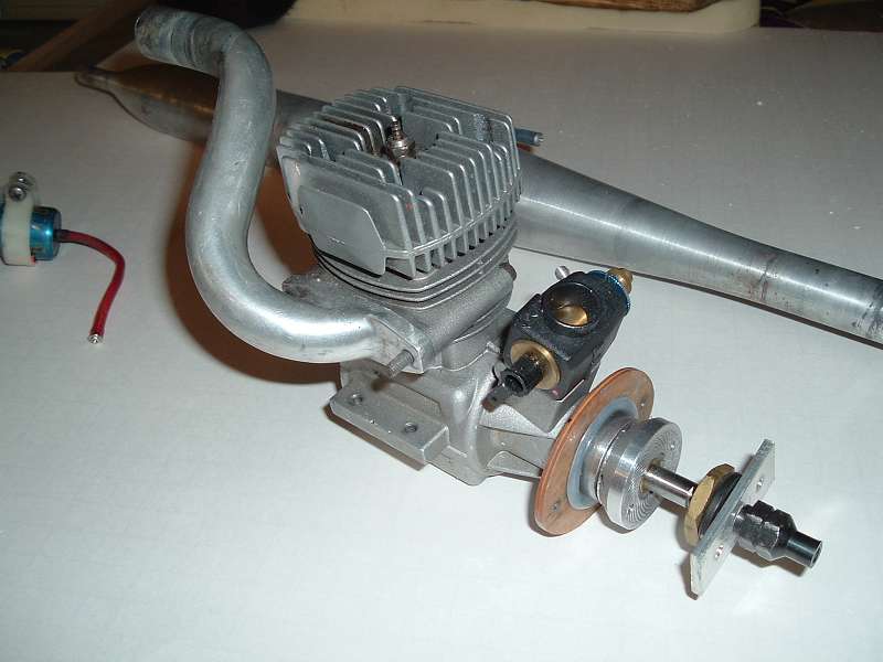

I have run the ST2300 in both a pattern plane and a 25% CAP
The Cap I used a bisson muffler, Perry pump/carb setup. It would turn an 18x6 OK
Pattern setup Perry pump/carb, 15cc Mac's quitepipe, 15% Ritches Brew and it would spin 8400rpm w/17x10n
get a Perry pump and carb and dont worry about the rest... $35 pump $38 carb
I still have a ST2300 w/perry pump/carb and Karl Mueller wraparound header and Macs 15cc quitepipe if anyone is interested in it.
$250 even throw in a new 17x10n APC prop. Complete setup INCLUDES nose ring and thrust washer puller and Tru-Turn spinner adapter nut.
