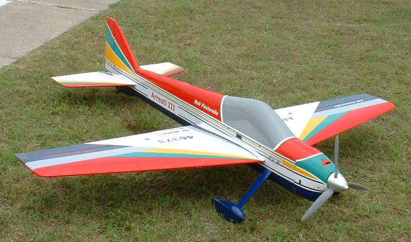

Schpankme's Avatar
Joined: Jun 2004
Posts: 267
Default RE: f3a artf
The Arresti III is undoubtedly the best "bang for the buck" in the F3A pattern Community today <period>
At the incredible price of $375 (307 EUR), this plane is a full 2M (ARF) pattern aircraft, proven capable of winning Master events.
[link=http://www.kmp.ca/contact.htm]Kondor Models[/link]
[link=http://www.rcaerobats.net]Bob Pastorello[/link]
_________
Schpankme
“It's all about the competition.â€

The focus is a very good plane for the money. The fuse looks small in the air. The canopies suck in the sun. I don't know how they finished at the nats this year but did do well last year. The impact is a great deal. The color scheme is butt ugly though. I think Bob is right that the Arestti III is a awesome deal. Haven't had the chance to see one fly. His website pictures make the plane look way better than on the planes own website. Seems like its quite heavy though. What class are you going to fly it in. I think that the only 2 compatible for FAI would probably be the eclipse and possibly the focus. I am probably wrong here. Just depends on the pilot and setup I guess.

Bob Pastorello's Avatar
My Feedback: (198)
Posts: 6,707
From: El Reno, OK
Have to clear up the Arresti weight issue. The NEWEST one is at 183.9 oz., over 5 kg. With CF gear, pants, and pipe, and changing my heavy battery to a lighter one, it will be 173.5oz, well under 5kg. MANY current state-of-the-art F3A designs sport all the SAME "CF" needs, and still come in at the same "nearly 5kg" weight limits.
Not pushing, just clarifying....data is on my website.
[link=http://www.rcaerobats.net/Arresti/arresti_iii_weights.htm]Arresti Weights[/link]

Old 09-21-2004 | 05:18 PM
My Feedback: (198)
Posts: 6,707
From: El Reno, OK
Have to clarify something....the Arresti, as manufactured by ESM models in China, various world-wide distributors is a continuing refinement of a VERY good design by Tom and Bill Bloodworth of Australia.
It does NOT - repeat NOT - come stock with ANY carbon fiber accessories. The stock wing tube and landing gear are aluminum, and pretty heavy. The latest built-up wing version is still right at 5.2kg or so.
To be FAI 'legal', one must install a Carbon Fiber wing tube, Landing gear, and wheel pants.
These modifications bring it to 4.9kg or less, easily.
Forgot to add that using a good CF tuned pipe or muffler ALSO reduces weight. Then lightened backplate spinner, and a few other things CAN bring this airplane to 10 lb 6 oz.
Both of mine started life well over 11 lb, and performed flawlessly. Lighter can be noticed, but doesn't seem to be much of a factor on this airplane. It has plenty of wing.

Old 09-22-2004 | 05:05 AM
My Feedback: (198)
Posts: 6,707
From: El Reno, OK
The current production version has a built up wing, with the wing joiner tube sockets going through 4 ribs in the wing, with plywood doublers on the outboard rib around the socket. In addition, the outboard end of the tube/rib is tied to the upper and lower spars in the wing. The wing tube length that goes into the wing has been increased from7.1" to 10.4", still 25mm diameter.
