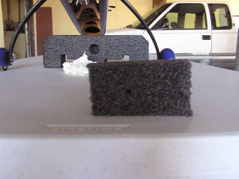

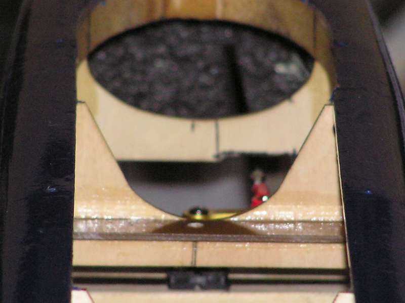

Hello everyone,
I’ve begin with the fixing.
I have cut a peace of a foam. The dimensions are W 2 ½ , H 2 ½ .
Hope this works.
I’m planning to push it till the fist former that you could see where
the Elevator servo is mounted inside the fuse, at the pipe tunnel.
Hi Bla Bla,
I have a Hyde A type Soft Mount for the Webra 1.60 Xp.
So I don’t think that is the problem.
The Fuse. it self doesn’t seems to vibrate that much.
Thanks a lot for the help, suggestion. I appreciate it.
Danny Koolman

Hello everyone,
Well here is how I did it.
The reinforcement with foam.
Hopefully this is the solution for my problem.
Here follows the Pic’s, form inside and the former made out of foam it self.
Regard’s,
Danny Koolman
Regard’s,
Danny Koolman

There is some good news, the fluttering problem is solved.
Thank you all for the (tip) advice, I’m very grateful.
Still have some minor set back, but soon en off I’ll get there.
Engine seems to be getting there to.
Hopefully everything will come a long for the upcoming Sunday.
Again thanks for all the help, I’m very great full.

Hold on a second here...you said that supporting the pushrod with foam has cured "The Hole stab is fluttering, very baldly. It seam’s like a bird wing when flapping. "
Mine is supported (with light ply formers) in three places along the body yet my stab shakes so bad it looks like it's about to break free! Is foam the answer here? Help, I'm not the only one.
