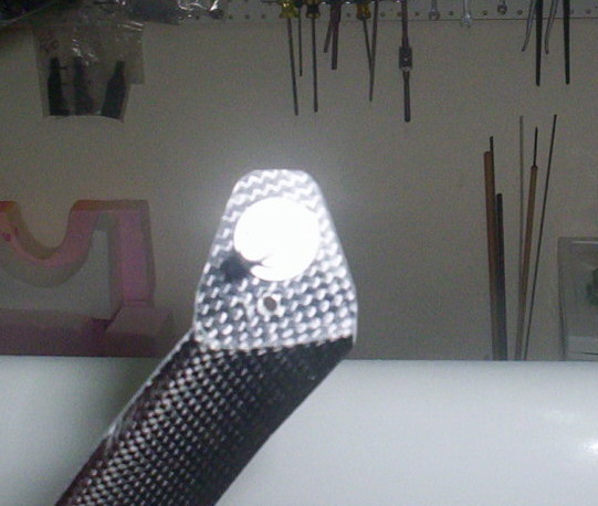

Rune,
My way of installing the wheel pants is as follows:
Drill a 1/2" hole on the wheel pant for the axle
Drill a hole for 4-40 screw at 3/8" top of the axle hole (and to the landing gear as well)
Reinforce the innerface of the wheel pant and glue a Du-Bro 4-40 blind nut
I believe the attached pictures explain the details.

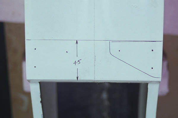

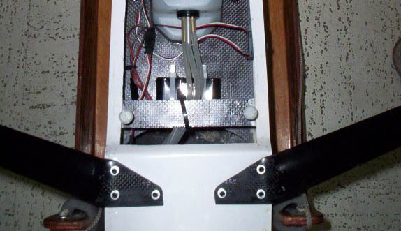

Rune,
For installing the landing gear, it depends to the type of fuselage you have.
For composite fuses that has a flat bottom and a belly pan, it is as easy as 1-2-3.
Glue a 1/4 air plywood from the inside of the fuselage using epoxy mixed with micro balloons.
I laminate CF cloth to the both faces of the plywood. I recommend glueing plywood reinforcement at the sides of the fuselage. Not required for good quality Carbon-Kevlar fuses like PL Lazulite, ZN Enigma (NBE Mantis Ex as well)
Drill and install blind nuts at the fixing locations. 3 x 6-32 socket head screws recommended for each LG leg.
Hope these help!

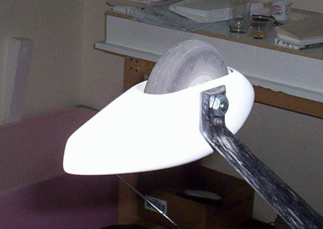

I TAKE THEES PICTURE FROM THE WEB, ON MY NEXT PLANE I DO LIKE THEES

El Tucano, I did that on my smaragd, really strong, but a bit heavier.

I install mine with a 6-32 socket head bolt throught the strut into the pant. I built up the outer edge of the pant and inside with lt ply so the wheel will stay centered in the pant opening. Use a 6-32 blind nut on the inside of the pant and drill a hole through to the outer part of the wheel pant the diameter of the 6-32 bolt. Just run the bolt though and tighten against the strut. I dont even use a locater pin to hold the pant in posistion if the pants are smooth against the strut. They stay in place well and if you do land hard or awkward they will just give a little and a quick twist with the ball driver and they are back in place. Using the Bolly style wheel pants is even better as they have an indent already molded in the pant to fit thier c.f. landing gear struts.
