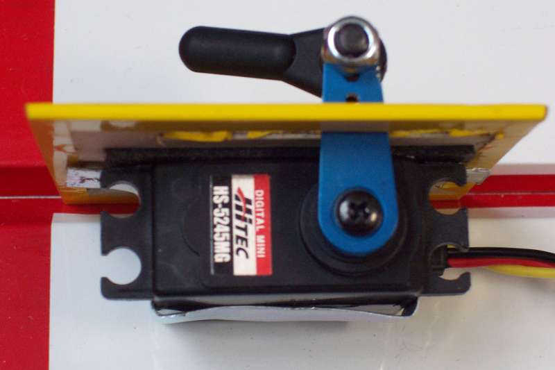

I use two mini digital servo's for the elevator Hitec HS-5245MG and as an engine I use a Webra 1.45. To balance the plane I have the receiver next to the wing tube and my battery (2300 Nimh 6V) right in front of the fuel tank.
No problem at all with balancing when u use the 2 servo's.

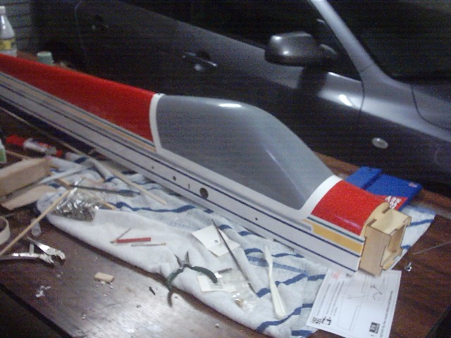

Below are some poor quality pics of my canopy attachment method now finished. I hated the idea of 6 screws to be fiddleing with so made a frame to support the canopy at the top of the fuse rails. I have two pins at the front of the frame locating into holes drilled in the forward ply bulkhead and one 4-40 bolt and blind nut at the top rear of the canopy to hold it in place. Its a snug fit and nothing will move or flap. Im impressed with my own ingenuity here. I made the frame on the fuse to get it a perfect fit. Smeared some vaseline at the four corners to stop it sticking and used some 5 minute epoxy to tack glue the frame into the canopy with the canopy held in exactly the right place, then removed the canopy and fame and epoxied the rest of the frame into the canopy.
I see Arresti III decals in pics of the model, (Aruba's and Aerobobs). Did they come with your kit or have you had them made for you ? Mine didnt come with any decals.

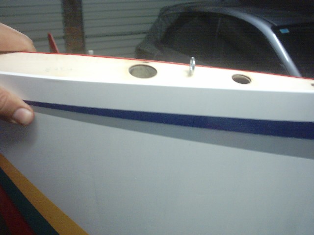

Here is a pic of my modified wing attachment method. The supplied single threaded anti rotation pin and nut method seemed dodgy to me, only holding at the front of the wing. It also interferred with installing wing adjusters.
Using the hole for the servo wires for access I glued in a length of ply, (actually 2 x 3mm laminated together to make one 6mm thick piece) for support to the root rib and simply drilled through the root rib into the ply and screwed in (with thick CA), a 25mm x 3mm eyebolt. Made a slot in the fuse side and will hold the wings together with either a nylon zip tie or a heavy spring if I can get one the right size.

This is exactly how I do mine!!! GREAT minds think alike on this stuff!! Except I use a short piece of 10mm dowel, epoxy into the root rib, flush, drill and install the eyehook screw, ca, done. I use the nylon tie wrap to connect them inside the fuse, also. Very solid.

That wing retaining method is just what the doctor ordered! I have rebuilt both wing tubes following a failure, and now I have a small gap at the trailing edge, which would benefit from your eyebolt solution. Thanks mate.
