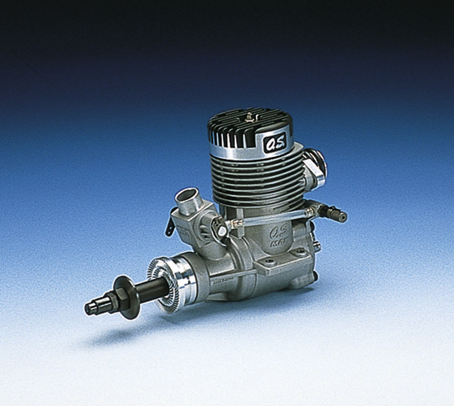

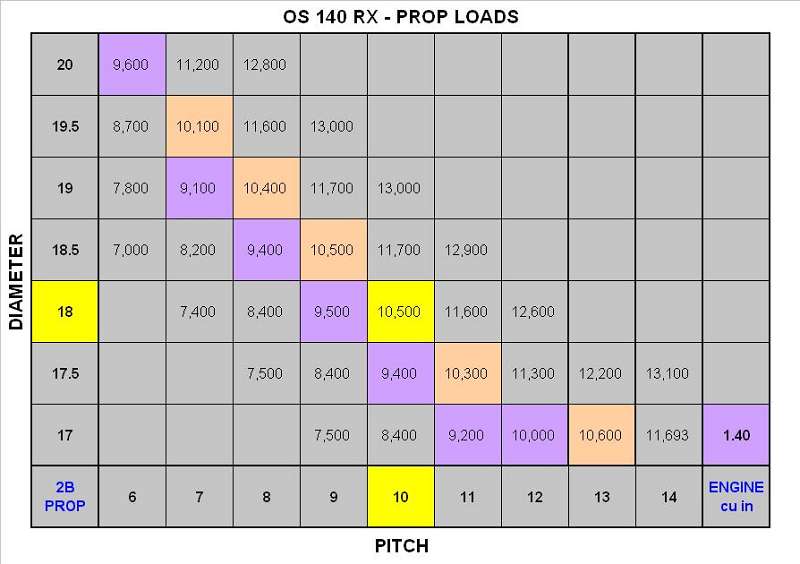

As seen in the two blade (2B) prop chart provided, an APC 18x10 prop is at max load for the OS 140 RX (tuned system).

Having carried the gentlemens Symphony OS140 18X10 out to the flight line at Larks. I really doubt it was turning 10,500.

That chart looks funny, why do RPMs increase with increasing pitch?

Who said it means RPM ?
The numbers inside the chart are loads.

ini, is right.
The numbers inside the chart represent prop loads. Finding the "like" prop load tells you which prop "might" be a good match.
Note: all props are not created equal, the chart is meant as a handy reference tool.

What is the source of the chart?
