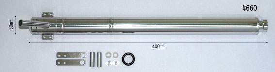

Below is a picture of what Hatori is calling a muffler for the YS110.
[img][/img]
Sam

Old 12-12-2004 | 06:20 AM
My Feedback: (12)
Joined: Dec 2003
Posts: 1,025
From: Rockledge, FL
Default RE: Tuned exhaust for YS 110
thanks Sam, I saw that somewhere and it looks about right. Just didn't see a price on it.
