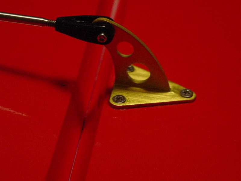

I use a ply plate mounted flush with the surface. I then attach the MK offset control horns. They attach with 3 tiny #2 size wood screws. The screws come with the horns. They work great and are adjustable for height. Also these horns put the pivot point over the hinge line.
I use the MKD0815 these are the medium aluminum horns. They also make a small horn too. In other situations I have used the MK large aluminum horns and converted the Offset horns to make them the large size.
Works well.
I use these for ailerons, elevator and rudder.
A dremel router bit set to the depth of the plywood plate, I choose about 1/8th inch plates, will remove the balsa tot he proper depth. I then use Pro-Bond polyurethane glue and clamp the surface to a flat table. This keeps the plate flush with the balsa skin. Sand it and fill with model magic around the edges of the ply plate and once covered you can't see the the plates. To install the horns I drill the hole equivalent to a #2-56 drill for tapping. I then run the wood screws in, remove them and use foam safe CA on the holes to stiffen the wood.
Once its covered and ready to install the horn I use some thick CA in the hole and run the screw in. Have not had one vibrate out, no plates come loose, and the setup is clean and simple. Also it saves me lots of time in setting up the bolt thru control horns. Another advantage is the horn load is now spread over a wide area. Another great thing is the tops of the control surfaces are clean and have nothing sticking out.
Not the cheapest solution but I think the time saved and the finished result is worth the extra $25 you spend on the model. Others will disagree but to me its worth ever dime I spend on it.

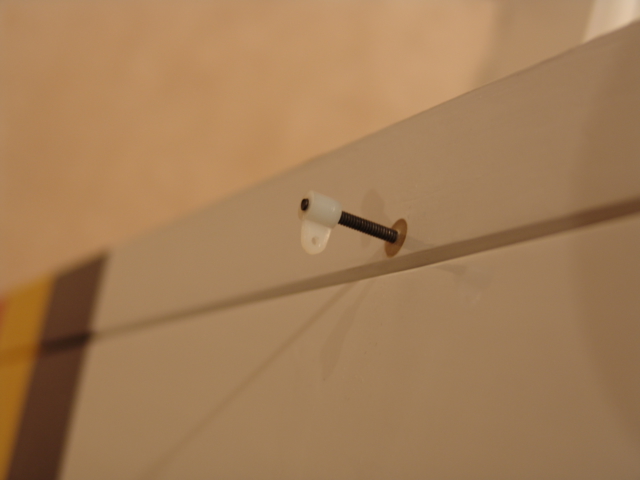

This works well for me and it’s easy and quick to do. There is a hardwood dowel in the control surface with a hardened socket head bolt with the head cut off. Quick and clean! I usually put the dowel in before finishing but in this example the dowel was put in after the finish work. The eye of the connecter lines up with the center line of hinge almost by default.

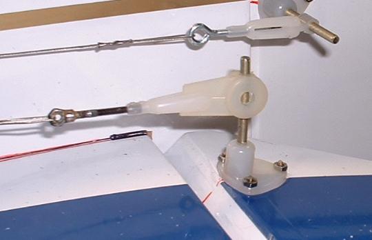

Hi Troy,
Here's a couple of pic's of some hybrid horns that I made from Chip's bb horns and the MK versions. I have not found a better clevices part yet. this one does not either have slop in the bearing inner ring fit or bind on the bearing.
Eric.

What if the normal MK horn was replaced with straight all-thread that had a (near) 90° bend facing forward (over the hinge line). The all-thread could go through a threaded base with a jam nut. Any excess thread would be down inside the flying surface. The hieght of the horn could be changed one full rotation at a time, and the distance to the hinge line could changed with one rotation of the MK plastic piece. Of course the all-thread would have to be bent carefully with heat to retain strength...
here is a quick image of the idea...no threads shown on the all-thread to speed up the modeling...
Any comments???
Any comments???

Jeff, you might consider doing what I have done. Go to the local ACE hardware and buy 1/4" OD aluminum threaded bushings. These come in a various lengths, so buy a slightly oversized length. Look for 6-32 threaded stock items. Epoxy these into the control surface and voila, instant hard point that has a built in thread. There's no need to cut these flush to the surface. You can make a very neat installation into the surface with care.
As Steve stated, don't use all-thread material for horns. But screws will work great. Following Ron's note, to bend them easily such that the horn is right over the hinge line, use another bushing on the screw, and you get a nice handle to work with. It's very simple and effective.

Anyway - for fear of offending the pattern gods, and the exclusive, nearly-unobtanium parts that components must be made of....several of you are following my Excelleron thread, and I had assymmetric offsets on the pull-pull horns. Threaded rod sunken into triangle pads screwed onto the control surface a la MK (sort of).
Solution to get to the hinge line (barring the use of either Sullivan # 566, or Dubro 867, which both have long plastic parts for the clevis), I came up with these. Yes, those are Dubro regular old steering arms with the collars discarded, then they are drilled and threaded onto the 3mm rod. Little 3mm nut, drop of Loctite. Hold control at neutral, drill hole where desired.
It is definitely Un-trick, and Un-pattern-ish, but golly .... it sure solved the problem and actually increased the load bearing area of the threaded control horn part....
Enjoy, and think about it after the laughter subsides.
