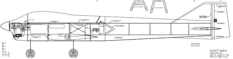

I purchased a set of Insight CAD drawn plans from the designer flyintexan that has is build thread on the forum at: http://www.rcuniverse.com/forum/m_28..._1/key_/tm.htm I wanted to do some experimenting with the design to modify it slightly to make it an Insight with a retro look. I chose the Insight because the design and engineering work is extremely well done and it flys awsome.
I wanted it to have a 80s retro look with tri gear retracts, anhedral stab, side mounted OS 160FX with a standard muffler. With the OS 160FX side mounted I wouldn’t need the lower channel in the bottom of the fuselage for the pipe, etc. To make the retract main gear legs a reasonable length I lowered the wing to the bottom of the fuselage. I figured if Chip Hyde's new design has the wing lower for better visibility that the 0 0 0 fad might be fading. If I extended the main parts of the fuselage down around the wing area the wing could be moved to the bottom of the fuselage and still use the wing tube. The nose gear looks like it would mount nicely behind the firewall but the main gear wheel wells end up too close to the wing tube. Might need to move the wing tube forward a little to get the gear placement correct. I’m not sure where I’m going with this but its fun to have the plans and play with ideas. I want a 80s retro look and the front now looks like a cross between the lower part of a Tipo and the canopy area forward like a Blue Angel and the transition line behind the canopy that slopes back to the tail. I made little scale foam model to be able to visualize it better.
See some of the modifications to the plans in the image below.

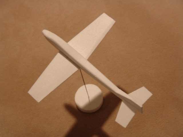

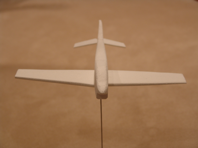

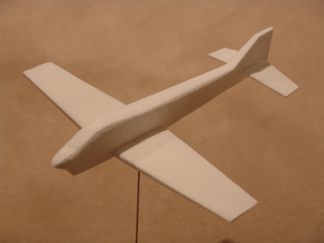

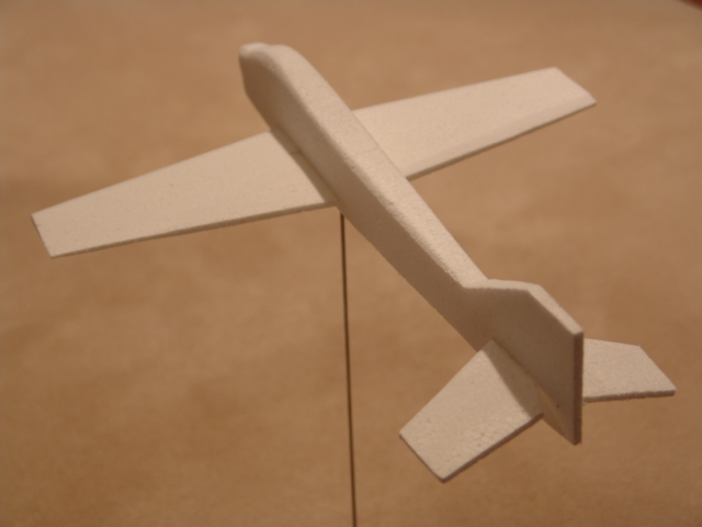

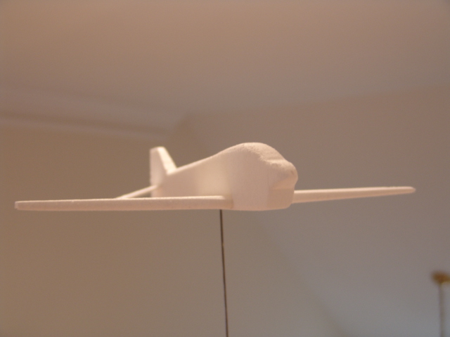

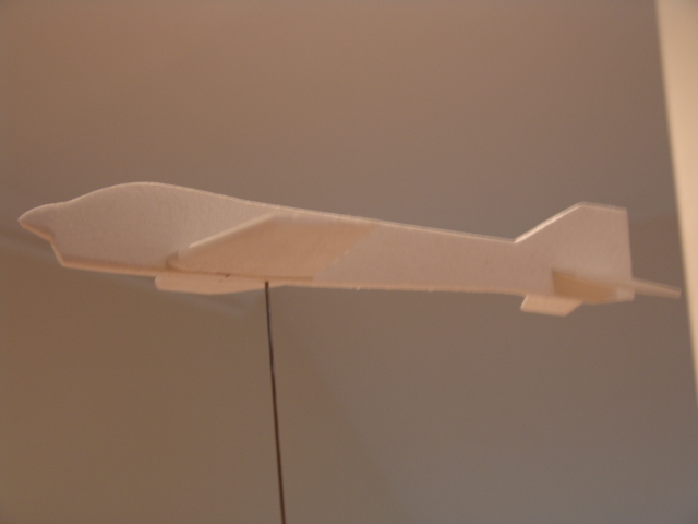

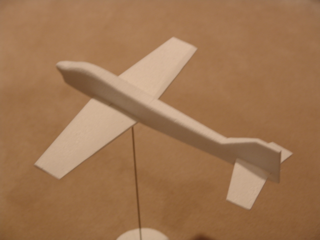

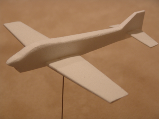

More images of the scale model. Pease ignore the warp in the right wing, I don’t have all sanding done on the model yet. The model is very helpful in viewing the shape from any angle and making changes to make it more eye pleasing. From some of the views I can already see that big 2M ship in the air.
To be continued…

These are things that have been modified:
Side plan view of the fuselage.
Fuselage is narrower by 1". Might need more.
Vertical stab leading edge angle changed.
Will use side mounted engine.
Nose side farings were removed.
Nose and main retract gear installed.
Wing lowered to the bottom of the fuselage.
Angle of the bottom part of the rudder changed.
Lower part of the fuselage ahead of the rudder bottom changed.
Area behind the spinner was change to mold into the spinner shape.
The air intake at the front of the fuselage was moved back.
All the moment arms remain the same.
Wings and horizontal stab remain the same and stab anhedral added.
All of the contraction techniques would remain the same excluding the removable front top of the fuselage that would be fiber glassed directly over the foam because of the complex curves.

I like the looks of that, although because it is different in many ways, only a flight test will tell how it acts in all axes during flight. One thing to remember is that the wing area is rather small (approx. 880sq.in.), so try to keep all mods light....if the trike gear adds significant weight, you might want to ponder adding a bit of wing area....maybe add 1-1/4" or so to the chord of the wing...that would give you about another 100sq.in. to keep the wing loading down.
If I can provide you with modified templates, I'll help in any way I can.

Nifty idea! I've thought about building a 110-120% Tipo and using an OS120....
Yours would be awesome! The Tipo has such nice lines, good to see that styling alive and well.
Just an fyi, for the os160, if ground clearance for the prop becomes an issue, many pilots use an apc 3 blade prop (15" diameter, I believe) that is re-pitched by Dave Lockhart.
You may also be able to extend the gear legs without ill effect by using carbon fiber struts in place of the original ones...MTK has posted on that topic before.
If you do build it, post some photos for us!

Try making a foamy first with the right geometry and get dihedral angle. This will translate to the larger model fine.
I like your thinking on this project. Hope you go through with it. You will learn alot. Good luck and if I can help with the design aspect, let me know.
