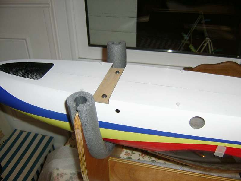

I am about to flight test my new Impact. Testing a new plane is usually something to look forward to but with all the failure reports I am not so sure about this one. I've installed a depron board all the length of the fuse and also a former in the rear. The rudder is scratch built from balsa (50 g) and hinged the traditional way. The pull-pull cables are attached higher on the rudder to reduce torsional load on the rudder itself.
After all these mods I am still a bit worried and as a final measure I have added several strips of glass-reinforced tape on the OUTSIDE of the fuse. This tape is very strong, sticks well to the surface and will act as a rip-stopper in case the fuse shell should develop cracks.
The tape is not very visible against the white surface. However, it is a shame to make a brand new plane look repaired before its flown. ...

The test flight went OK, at least no cracks in the fuse !! Have to adjust the right thrust and CG. It was too tail heavy for my liking, didn't have the 'locked in' feeling. I think I will fly my old Synergy in the first competitions and fine tune the Impact in between.
