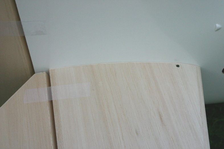

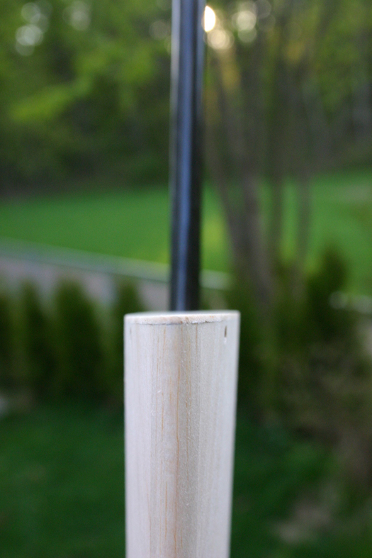

Wing fit detail, remember this is straight out of the box with no fitting or finishing... it's perfect.

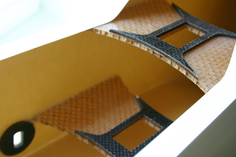

Some details... how much work do you need to make a nose ring mount, servo trays & tiny carbon servo mounts built into the wing?
By the way, the servo well in the wing is lined with ply wood at the ends and balsa at the sides... the carbon mounts are recessed into the sides. Enough work to keep the most A' retentive customer satisfied.

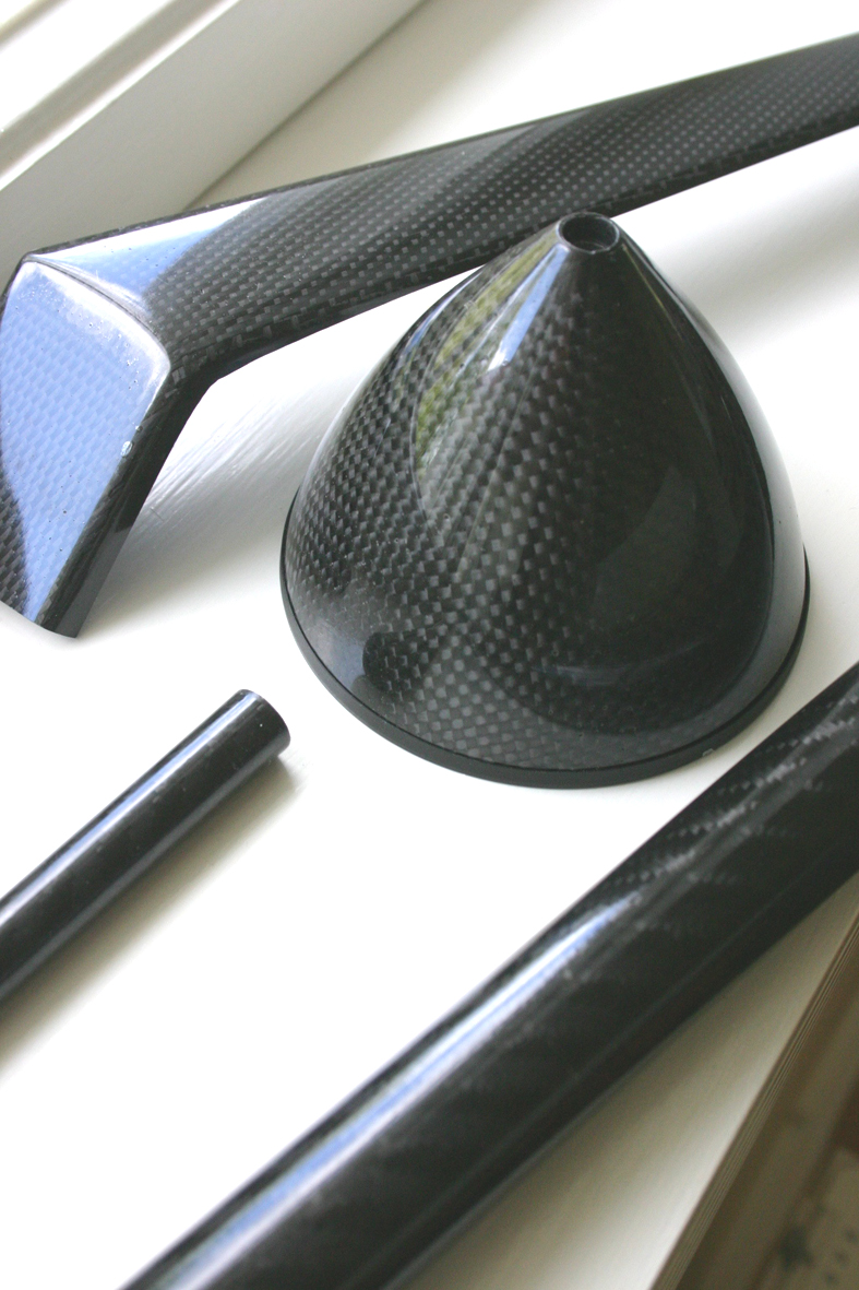

some nice carbon goodies and class hardware. Yep, those are genuine Kavan hinges... in two different sizes of course.

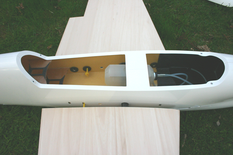

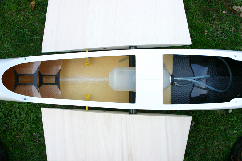

As you can see, this isn't a small airplane. The access through the top is excellent, the best I've seen. The hatch extends from the firewall almost to the eng of the pipe tunnel.
Thats a 580cc(20oz) tetra tank to give you some scale. The body is 18cm (7in) across at the widest point.

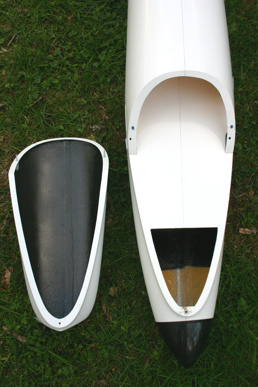

The hatch on the underside are also massive. An OS 1.40 is totally lost when placed in the engine bay.
With the cowl and the pipe tude removed, the flat underside is the datum line. Should make set up rather a pleasant experience for a change.
The nose ring and fire wall have the trust angles gigged in during the construction phase and are prill drilled for the mount/engine combination.
I'll fit the engine this weekend, I'll be very surprized if it isn't 100% spot on accurate.

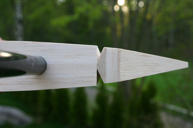

Some nice shots of the stab showing excellent fit and finish. Each stab half is side sensitive, on the 3rd pic you can see how it's been shaped to fit the contured shape of the tail section. The fit from the underside is just like the top.

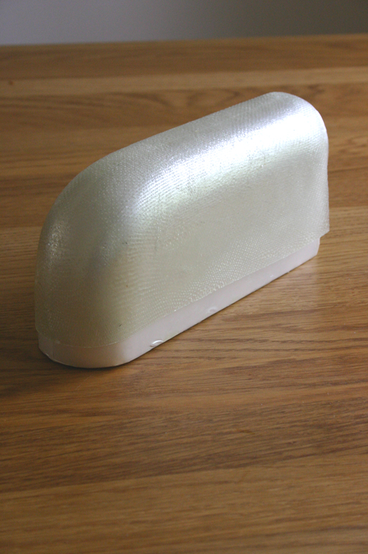

Because the GrevePipe I'm planning on using is so long, I had to make a modification to the underside of the body at the end of the pipe.
It almost made me cry to have to cut-up this airplane but Ijust followed the instructions from Ole Fremming excellent web site and all went well.
Make a balsa plug, cover it with film and shape some class cloth over the top.
The finished quality of the surface that was against the film is quite remarkable. Very smooth.
