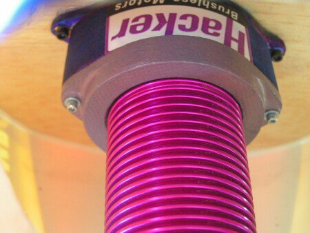

Look at the prop in his model!! Two different props (No 4-blade prop!!)

Interesting! Any chance you have more informations on the setup? Looks like someone's trying to deal with the huge diameters ( 23", 24" ) whe see nowadays on some setups...

I don't know what props he used. In my opinion it's 2 props, not at 90 degrees. He used Hacker engine.

Todd Blose had one of these on his electric Genesis at Nederland. It's not two props ,
it's one custom made electric prop with 4 blades. Sorry, didn't notice the size and pitch.
The blades are NOT at 90 deg to each other. Todd said it is very quiet.

Here is a picture of Todd Blose's X electric props. As I recall they were one 18" prop and one 17" prop. Sorry I don't have the pitch.
He had not flow the plane when I took the picture.

Its 2 different props with a small piece of balsa (or plywood) between them and glued together. He is using the 4blade mainly to stay away from the large size of the 2 blade. He didn't put them at 90 degrees for the same reason the Helo's don't.
Here's my problem with it, you have engineers that actually put the props on the Helo's at specific angles with lots of models and testing. Chip just placed his at those angles and hoped for the best, there is no way to know if at that specific angle its performing at optimum ranges.
------------as far as performance........I saw 2 Genesis electrics fly that day. They both looked fine, no problems at all. Did chip's look better? Yes and no. He flew better but I don't think the prop had much to do with his smooth lines. Infact he had a midair and lost most of a wing, then borrowed a wing from another Genesis and finsihed his round. He flew just fine like that. He can fly......no matter what, basically.
