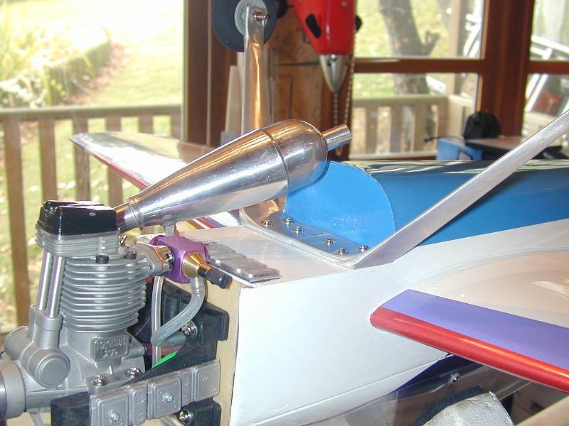

I posted this on another Groovy site, but thought I would put it on here as well. this was before I stuffed it.
Running the Groovy last week in no wind it would not take off from the grass patch, which was not that long, so programmed in positive flap on the side slider of my Tx and it poped into the air no problem, have any of you guys had a problem with excessive take off length?

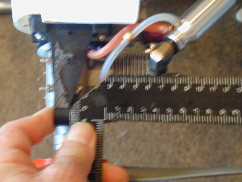

You have given me hope. I have been looking for a good plane to get back into pattern after a 10 year hiatus. I have an OS 61RF with pipe that I was hoping to use. Any way you could measure the distance from thrust centerline on your Groovy to the bottom of the firewall? I would be interested to see if I could get that header for the pipe over the wall and work that blue belly pan (you said it was glass?) into a pipe tunnel.

Have a look at the pic, from the centre of the crank to the flat area behind the engine is 50mm to the top of the fibreglass belly pan its 90mm so this makes the belly pan 50mm deep because there is a 10mm fall on the flat area towards the engine bulkhead, the only problem I can see with what you are proposing is possitioning the battery to get the correct cofg may not be a problem if your engine is heavy enough, I had to put my battery right behind the belly pan front vertical to ballance without weight.
Hope this helps, let us know how you get on, and post some pics of the mods.
