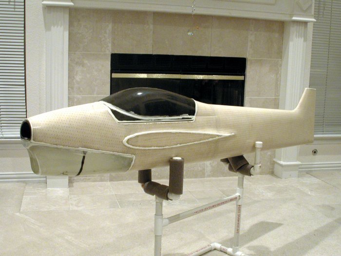

I'm building an Aries too. I've seen this plane fly at the contests this year and they are very impressive. They maneuver very smoothly and it's incredible the way they slow down on the down-lines.
After watching this plane fly I can't wait to get mine done!
I'm almost done with the wings and stab, next comes the work on the fuse.
Here's a picture of my fuse directly out of the mold from AeroSlave. Notice how much surface area the side of the fuse has.
Keith

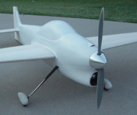

You gotta go with fixed gear Kieth. This plane looks really good with those Bolly's hangin down.
Let me kow if you have any questions on building or flying her.
Here's a shot of the fixed gear and mount setup.

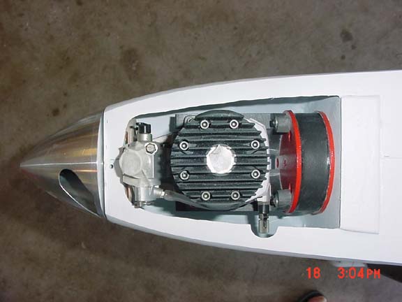

Do you have a closer pic of that engine mount in there?
Is that your own design?
You can email me @ [email protected] if you have any pics of it.
Thanks!
PS: Plane is looking good, I had a chance to look at the fuse in Muncie, looks like it will be a nice machine.

Do you have any idea how much trouble I went to cutout and build those gear mounts for the retracts in the wings!
Not to mention the weight I added with the mounting plates!
I've sheeted the wings but haven't cutout the balsa that's covering all of my hard work on the retract wells, so conceivable I could still change my mind and go with the fixed gear. Hum, I'll hold off on cutting out the wells and think about it for a bit. You are right that it looks awesome, not to mention there's less to go wrong than with retracts.
My biggest reasons for going with retracts are 1) fear of having a dead stick landing in the weeds and tearing a hole in the fuse by yanking the fixed gear off, and 2) those fixed gear bounce more than retracts which means more deductions on the landing (that may be silly, but hey, it is a factor).

Posts: 821
From: Plano,
TX
Just a pipe tunnel floor and a cross brace to hold the fuse side while setting up the wing tube and servo rails the rear crossmember was removed after everthing was installed. There is a half pipe fiberglass tunnel available also if you didnt want to do the balsa floor.

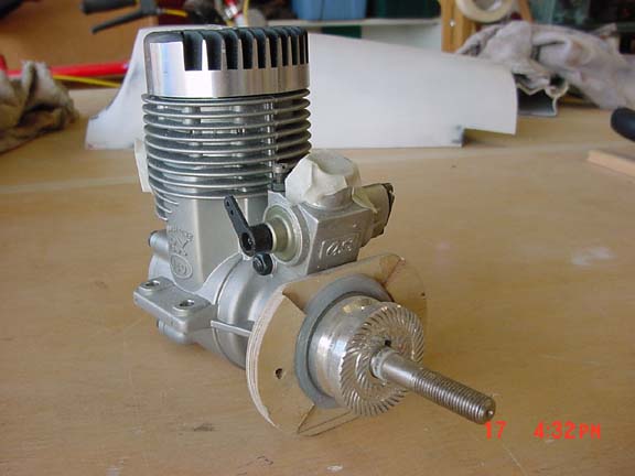

A shot of the nosering, 1/8 a/c ply and med blue fuel tubing.
See some other full shots here on my photo gallery.
