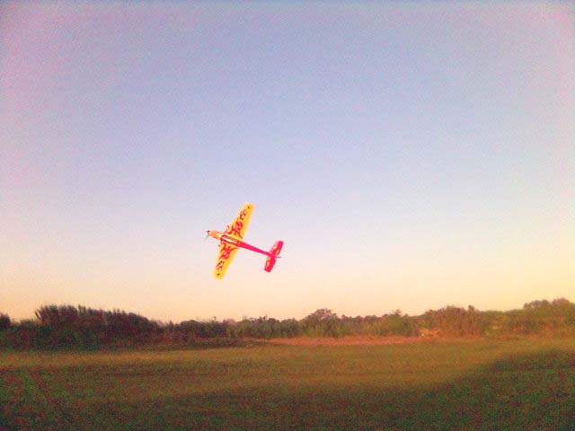

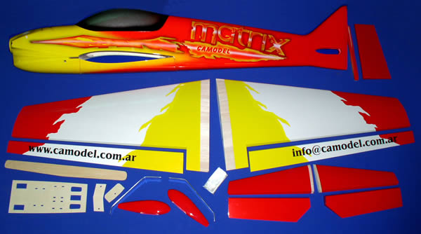

Default NEW CAMODEL'S PLANE

Anhedral?

Yes, anhedral!!

looks like Eclipse fuse with Genesis stabs/rudder/wings

It is for PATTERN?, and which size is this plane? is it for a 90 size engine? or a YS 110?

Engine: OS 91FX (Perry pump in prototype)
Span: 1600mm. (63 in.)
Lenght: 1650mm. (65 in.)
Weight: 3400g (7,5 lb)
MORE PICTURES SOON...

Looks a lot like the Epsilon

Yep I agree, definately looks like an Epsilon with a fibreglass fuselage and some anhedral in the stab.

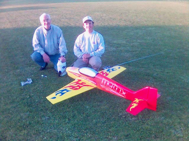

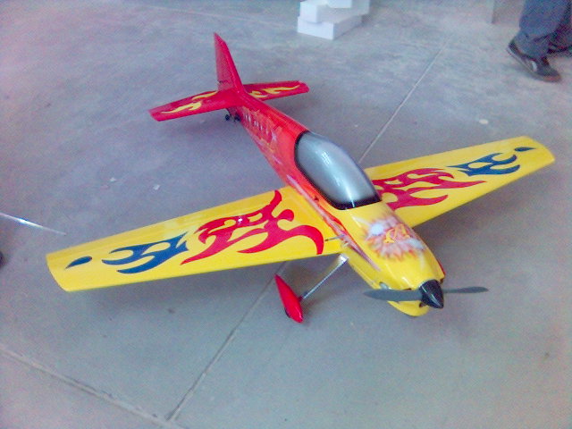

Hi
others pics of plane Matrix Camodel

I regret to inform that this nice looking plane suffers several manufacturing problems: I saw two different planes breaking wings in two in the same flying day... in one plane the wing could be replaced (2 weeks after) and was again broken in two.
The curious thing is that the collapse happened while the plane was flying straigth and level... and first ever flight...

What construction method are the wings? Balsa sheeted foam? Composite hollow?

I think they are balsa sheeted foam..............

The only thing I could think that could cause that would be the use of a less dense foam in the wing. Guille you have any idea why the wings are breaking?

Indeed; they are built in sheeted foam. Wings are breaking due to poor wood quality combined with low density foam. According to the analysis we made, the cracks begun in the leading edge (yes, leading edge) near the servos bays and once the flutter begun the crack traveled directly to the wing root where the aileron begins. I shall remark that the trailing edge where the aileron is hinged (and this is a design failure) does not continues from one wing to another.
In my opinion, the plane can be good (I can't afirm this since the three flight I saw finished so soon...) but better material shall be used for construction and wing structural design must be revised.
