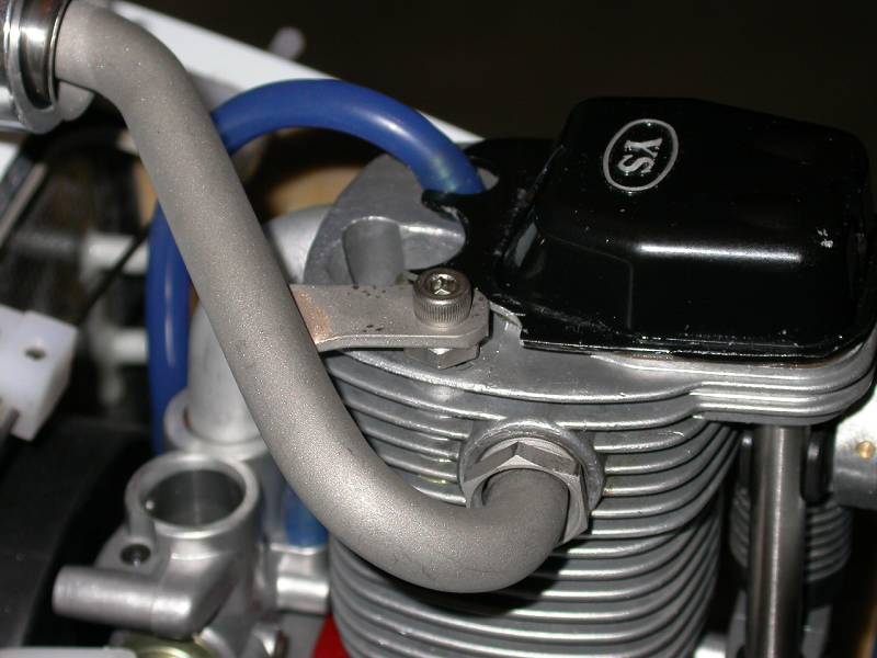

Todd,
I have just finished installing the 821 on my Astral XX (one piece wing) with a 160 DZ, but have not had the chance to run it yet. However, I will suggest using the Asano header instead of the Hatori one. The Asano has a metal tap on the side of the header so you can fasten the header onto the head of the engine, therefore, no worry about header coming loose. Also, be sure to have a slight clearance between the header and the pipe (10 mm) for expansion.
In addition, you should use a Nishioka soft pipe mount. I understand this set up works really well with the one piece wing configuration. However, I have had no experiene on a two piece wing design.
Good luck,
Adrian

Riot 3D any pics of what you are talking about?

Here are the pix
Adrian

Hello tschmidt
I have 2 Asano header.
The collet of the Asano header tighten by the nut on the cylinder head broke on every pipe after about 50 flights. I'm going to install Hatori because friend did a lot of flights without problem and Hatori is cheaper as Asano.

Papaone,
Which part of the pipe broke? The metal tap, or the flange?
I have friends using the Asano for hundreds of flights without any problem. Again, the key is to use the Nishioka soft pipe mount, and leave a gap between the header and the pipe for expansion.
Rgreen24,
The Hatori is 5,355 Yen, and the Asano is 12,600 Yen, which comes out to about US$47.00 and US$110.00 respectively. The difference is the Hatori doesn't have the side metal tap, and they only have 10 or 25 mm rise. The Asano comes in 10, 20, or 30 mm which fits my Astral XX.
Adrian

Hello
It's the flange of the header which broke. Others friends using Asano header had same problems.
So ZNLINE did'nt sell this header and replace it by Hatori header.
Yes there was a gap between header and reso for expansion.
Hatori don't need metal tape if correctly mounted.
Regards
