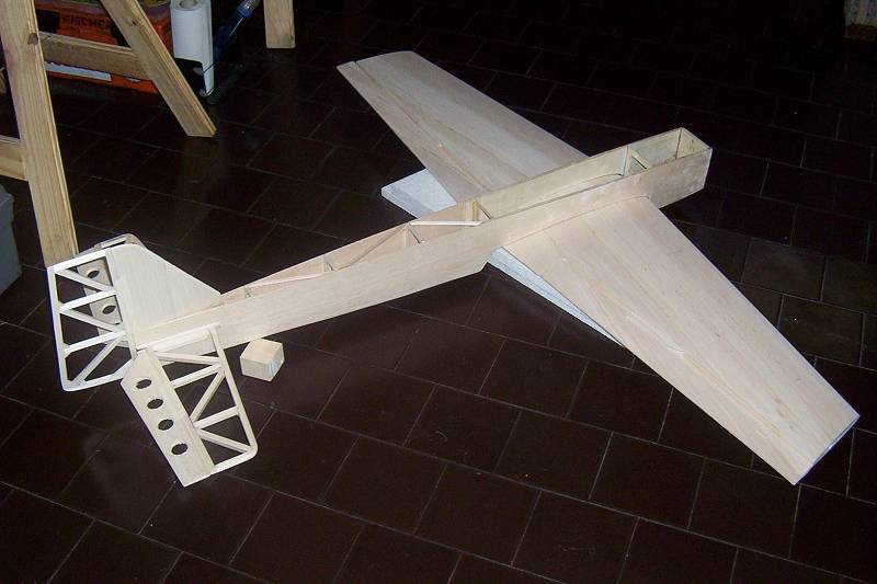

try in www.oxai-rc.com/showroom
with that pictures im building my 46 size pattern plane, not finished yet, buy has a great proportion and style
good luck

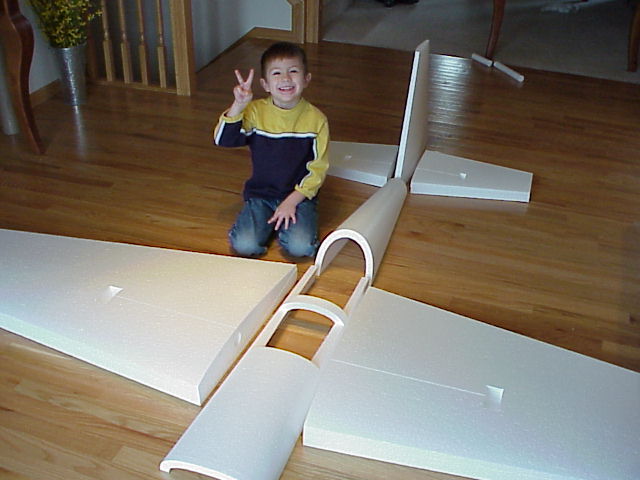

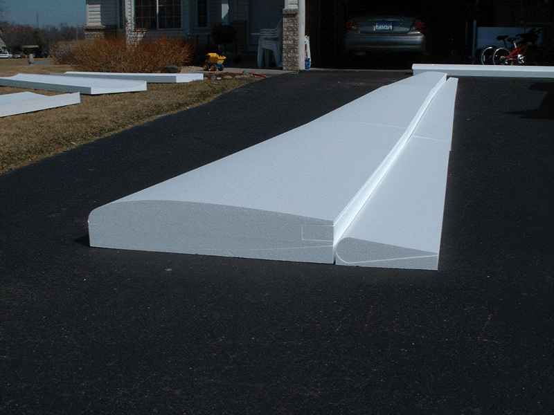

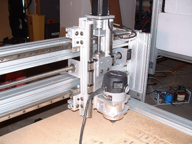

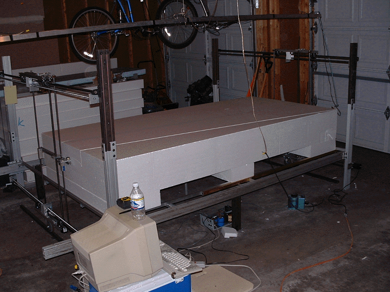

Yes, Im going to do something. I have a cnc foam cutter and a cnc router that I built.
I am also getting set up to do some 3D router work. Molds and the other parts. I have a thread here on that subject. [link=http://www.rcuniverse.com/forum/m_4080595/tm.htm]link to molding[/link]
I have not done any building of planes, but I love planes and technology.
here are a few things that I have done with my foam cutter.
Hurley Extra 300 foam kit.
Foam core for an ice boat, 26 foot length, 4.5 feet at root and 1.5 foot at tip.
I will probably do a thread of this build, of my design of a pattern plane. I will start out with drawings, in Solidworks and Autocad. then transfer into a build. Obviously with some help from the experts.

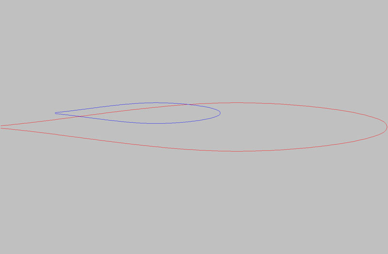

here is the chords with the tip scaled down to 10% thick

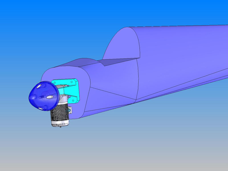

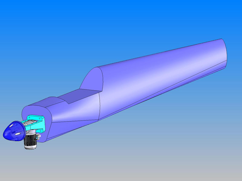

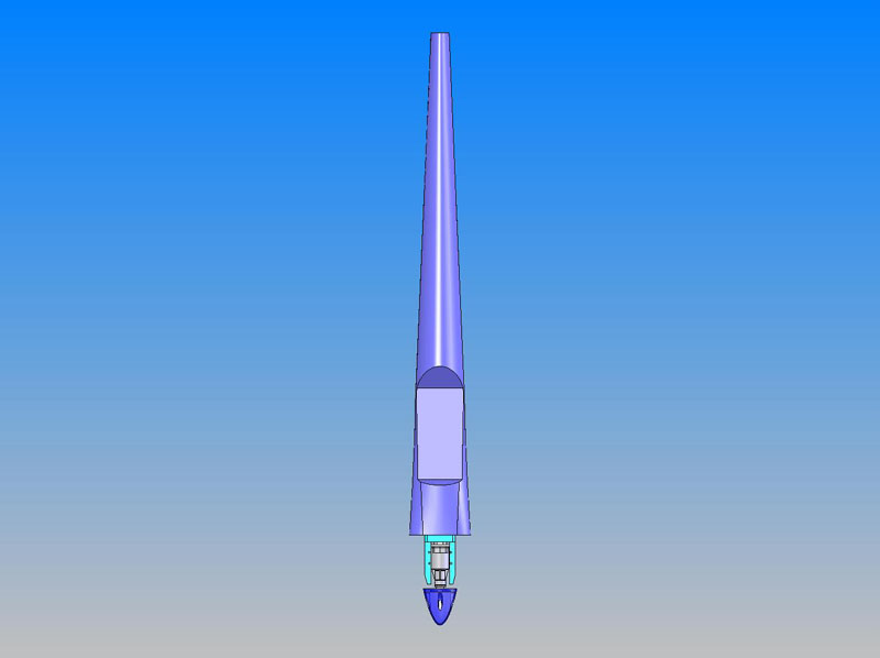

I worked on the fuse. this is what it will look like from the front of the LE of the H. stabs, to the nose of the plane.
I will have to work on the cowl, later. I will throw some wings on next, when I get some time.
EZ

I lowered the top of the firewall, so that the slope of the top of the fuse, near the front of the fuse, will match up with the cone. Hard to see, but I did do it.
Also widened the lower half of the firewall, it looked to thin, it looks better.
Added top view.
