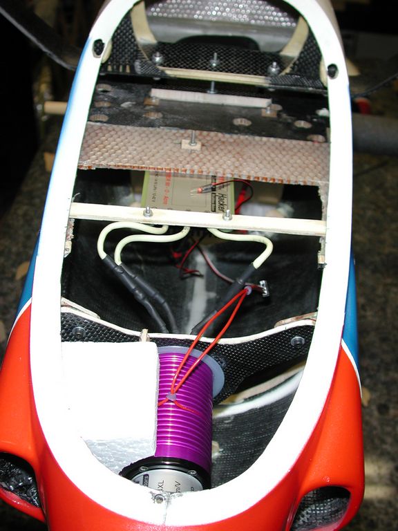

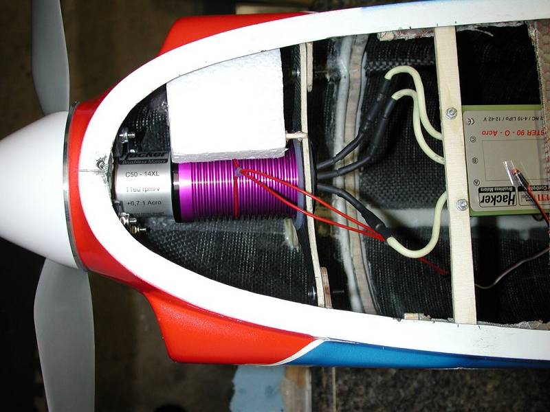

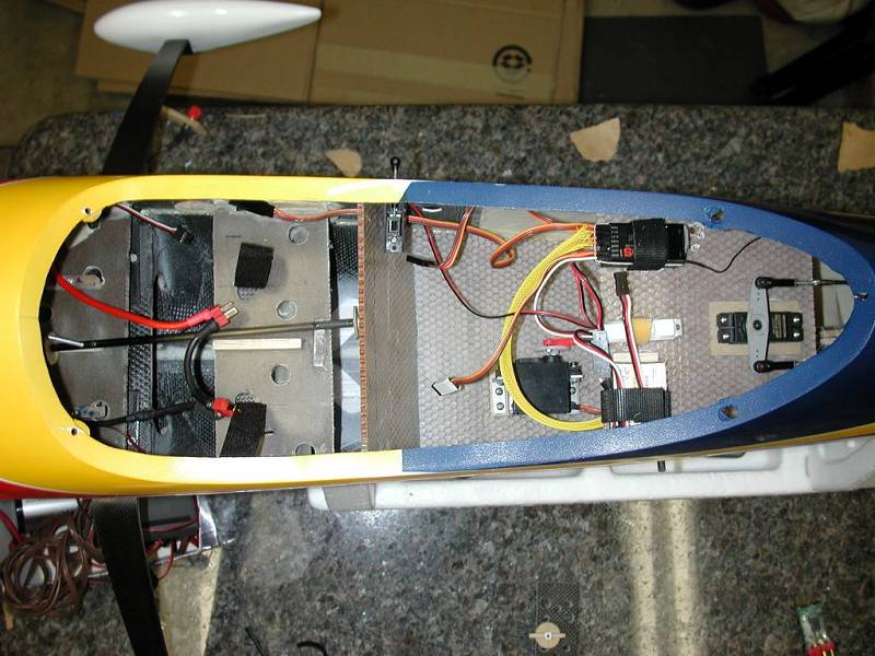

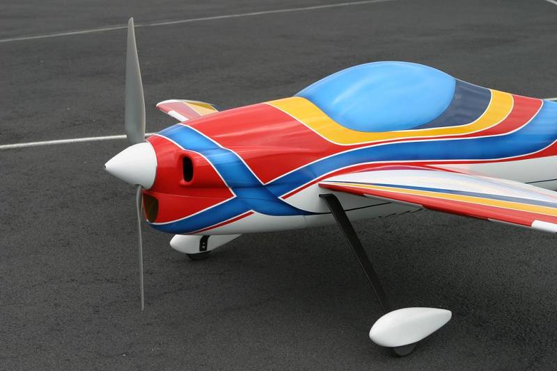

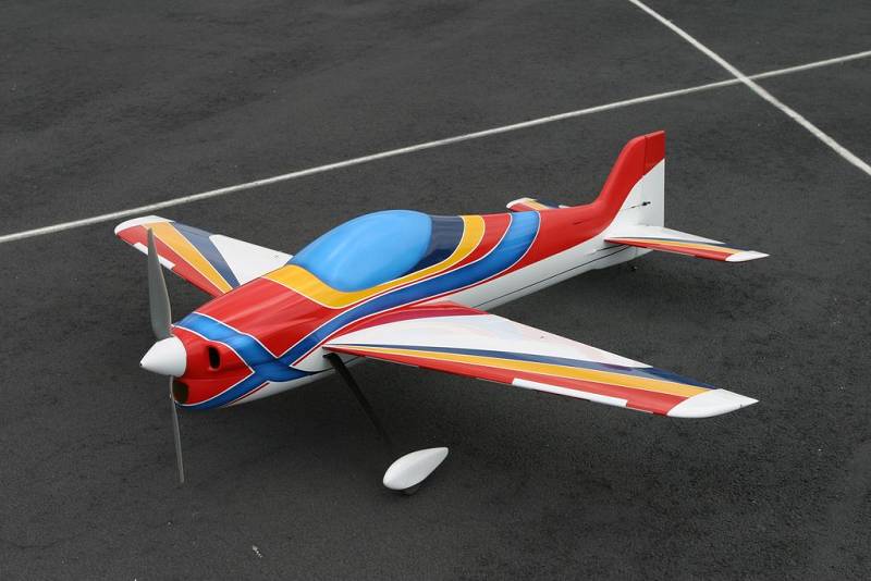

It’s about time! I finally completed and flew the Brio that I ordered last July after my Aries mid-air. Four months to arrive and six months to get enough time to put it together.
I put up five flights today. After a tweak here and there to the CG and throws it was doing really well by the time I packed up. I still have some adjustments to make to get the snaps nice and clean, but all in all I’m very impressed!
I set the wing and stab incidence as suggested in the instructions and to my amazement it appears to have no roll or pitch coupling in knife-edge!
It would be safe to say that I’m very happy!
Here are some pictures:

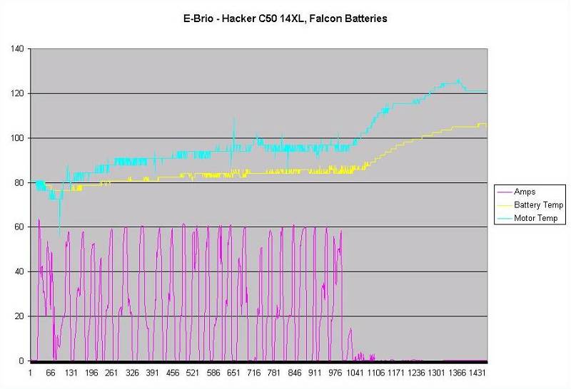

First flights were with the 21x14, Falcon F3A 5s2p batteries (apx 5300-5400 mah).
Yes, I'm using the Eagle Tree Data E-Logger. That thing is really an awesome tool for E-Flight, and not more than a really good IR Temp gun.
Here's a plot of the 5th flight, I've included Amps, Battery Temp and Motor Temp. It's interesting how the motor temp keeps cool until landing, then immediately rises.

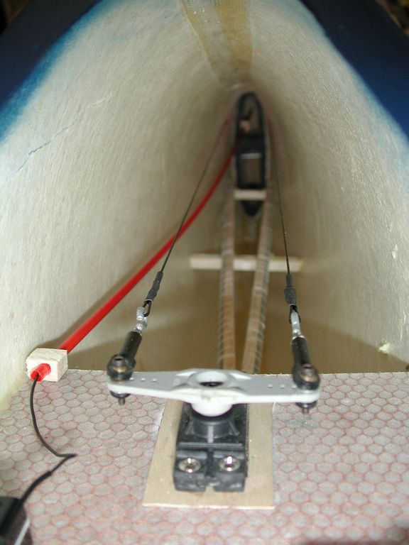

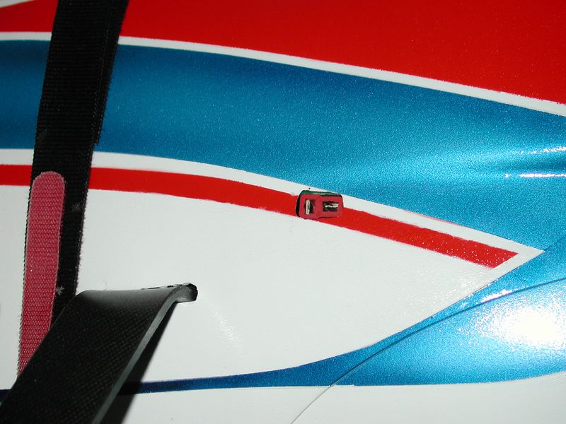

Here are some pictures of the arming pin from outside the plane.
Brett, the electric has some really nice characteristics and I think it’s going to be great. There are clearly some things I need to adjust for the slower speed. A couple of times I caught myself not realizing I was already at full throttle in level flight just before a vertical pull. I’m going to have to pay a lot of attention to throttle management and re-adjust my eye to the slower level flight.
Stuart, the current weight, with the 21x14 prop (lighter that 21x13W and 22x12), is 4993 grams. That’s REALLY close, but there are still two or three ways I can drop a few grams here and there to be able to run the heavier props. What made making weight tough is that the Falcon batteries are about 134g (4.75 oz) heavier than the Thunder Power. However, the technical arguments and the six month warrenty on the [link=http://www.falconbatteries.com/custompage.aspx?page=proseries.htm&selection=custo m]Falcon F3A[/link] batteries won me over. As long as I make legal weight that’s all I care about, I'm not obsessed with seeing how much under 5kg I can be. Remember a glow plane that starts at 9.5 lbs is around 11 lbs when fueled.
Thanks for the pictures. Weight wise that is as close as you would want to get. Hopefully no weights at a contest with a slightly off scale
I like the idea of a 6 month warranty as well but I do not think I would have risked buying them with the weight that close. I am waiting until I am pretty much sure of the weight before deciding on which packs.
Thanks for the quick pictures of the arming plug.

Keith.
You seem to be peaking pretty consistently at 60A during flight.
Just for interest, did you measure your static amp. on the ground?
Magne
Magne

Rm,
Unfortunately the way I have the data logger hooked up it’s only showing the voltage of one of the two battery packs, therefore the following number should be doubled (assuming consistency between packs).
At takeoff 60 amps drew the voltage down to 17.55v.
3.8 mins into the flight during a 4 second burst at 61.5 amps the voltage ranged between 17.1v to 16.86v.
6.8 mins into flight during a 2 second burst at 61 amps the voltage was 16.6v.
Keith B

Magne,
Here is a chart of the initial ground run. Numbers are pretty much the same. Again, the voltage is 1/2 the total voltage due to the way I had the data logger connected.
Keith B
Keith B
