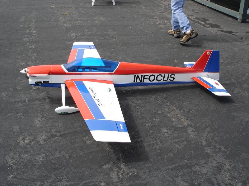

Old 07-03-2006 | 11:33 AM
Joined: Feb 2004
Posts: 796
From: Oakland, CA
Default RE: Clean Canopy Attaching
ORIGINAL: papadontscreech
Any ideas the cleanest way to mount clear canopy, can't track down pin striping and any glues I can think of will look terrible through clear canopy,
thank
I used white electrical tape to hold my canopy on my Focus - I flew it for 2+ years and never replaced the tape, nor did I have to fix the edges. Clean and simple to do... see attached pic. BTW, I attached the canopy on my 35% Staudacher using the same tape and the canopy is still attached.
