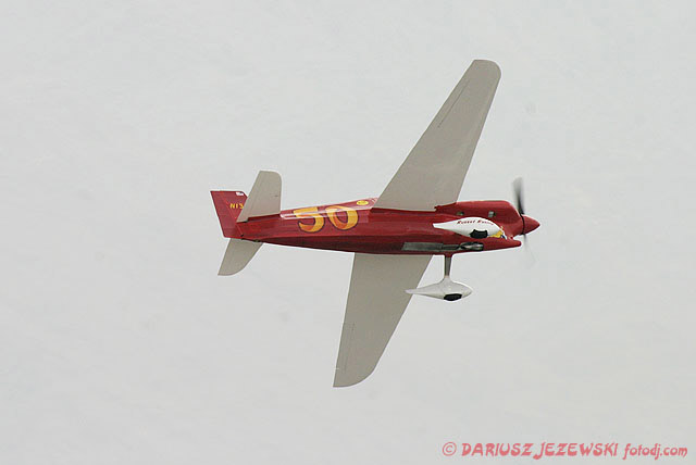

how about this? So far the best thing I have found as a base referrence
the wings to be short and highly tapered (the pic actually is of a long span plane)
The fuselage is quite deep -simply because the full scale plane is very small and the pilot fills top to bottom.
It is a Cassut Racer there are a million versions of this little bugger
