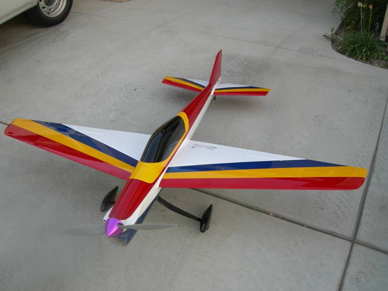

As stated I run the bolly electric and long gear. They both work good with my setups with 22x12's.
Good luck!!
Chris

Will do, Jeff. I think we're going to have to go with the Bolly gear. The only problem is our "slot" in the plane for the gear is only 1.18" wide and the Bolly gear is 1.25" . Guess we can do some trimming.
