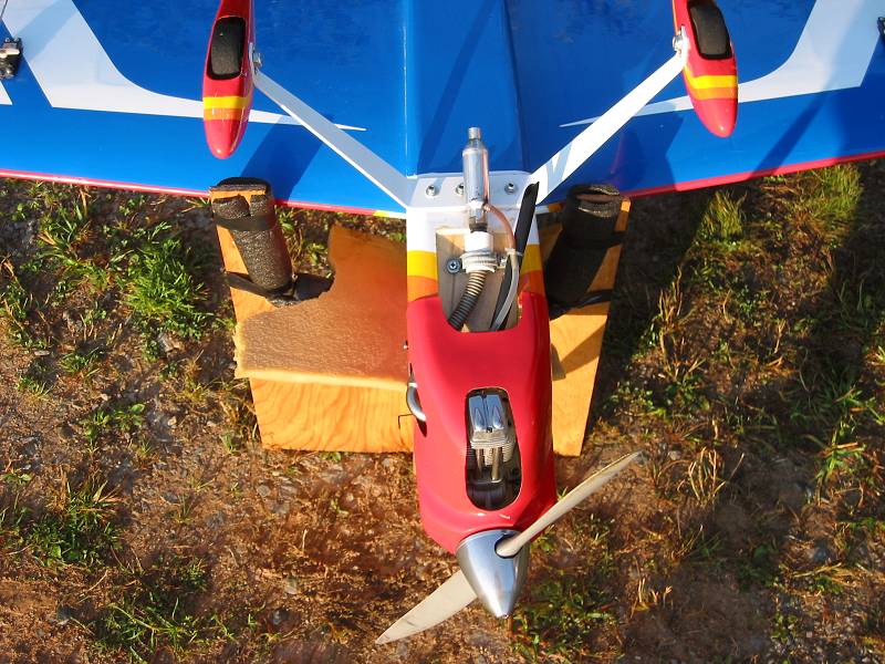

ORIGINAL: nrthwing
I just purchased a Venus II new and planned on using the OS 120 4 stroke. So far no one has mentioned that engine. Is the OS 120 2 stroke better?
Mike
Mike
Here's mine with an inverted OS 120 FS. 8.5 lbs. unlimited vertical and the truest plane I have flown next to my Typhoon 2000, and you can't beat the 4 - stroke sound

If you want to invert the engine and your using the non - pumped engine you should dremel out the formers a bit and turn the tank sideways. It lowers it about 1" and makes all the difference. If you want to exit the muffler under the plane - like I did - the in cowl hearder and flex pipe are available from OS. It makes a slick install as you can see in post above.
