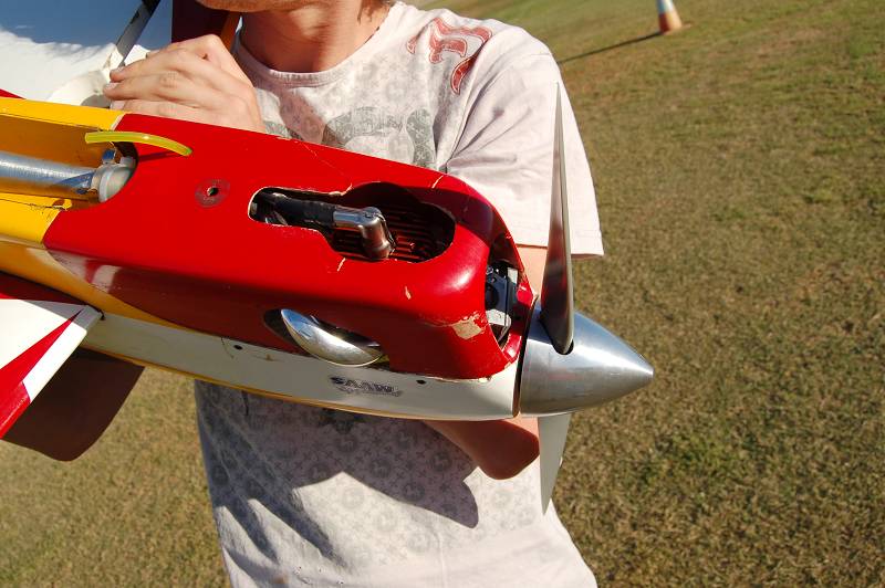

Okay, time for photo's.
For those who are interested in what the plane is, it's a Zytec 2, it's an own design from one of our local boys, and I've gotta say it's a absolute winning flyer.
So pure.
It's been through a few owners and the previous owner set it up for a DZ and I think he may have rearranged the front end, hence all the cracking but that'll soon be fixed as I have plans for a respray some time soon.
Took off, 3 clicks of right aileron and a few clicks of up and she flys like she's on rails.
Coudn't be happier.
So pure.
Coudn't be happier.
