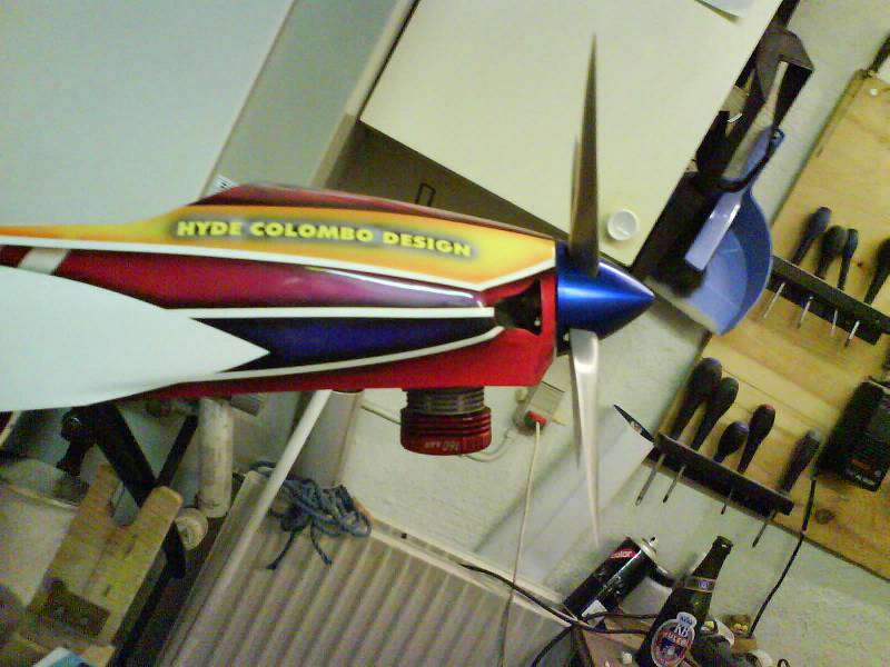

Default RE: Webra 160 MC Pipe Length
Hi
have 27, ½inches on 2 of mine webra ,,, it s where i find it best performens with a 4 B apc 15.5 12,5 prop...
