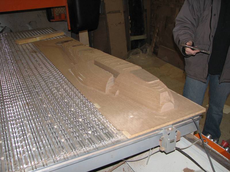

Old 07-30-2007 | 09:30 AM
Posts: 97
From: Noordbrug, SOUTH AFRICA
Default RE: BM V2.2 composite fuse info required

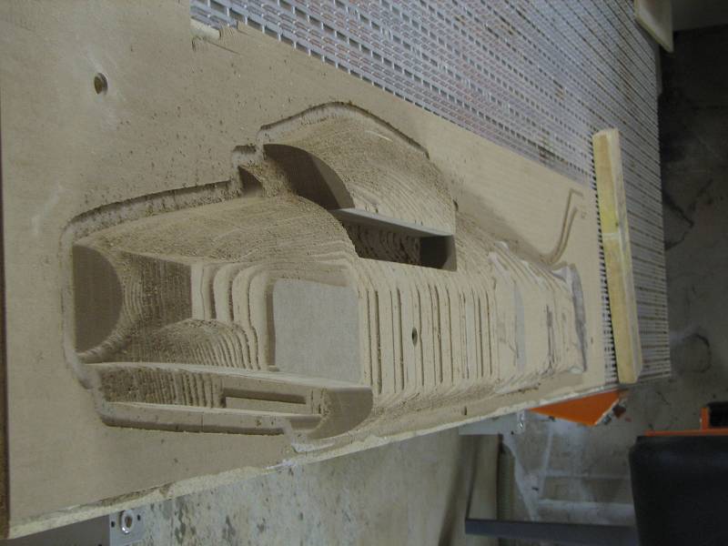

Hi Guys,
We have started cutting the plug on the CNC machine. It is a lot of work. The rough cut alread took 6h machine time. Will post some pics soon.
Regards
Attie

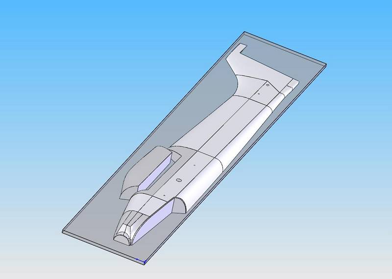

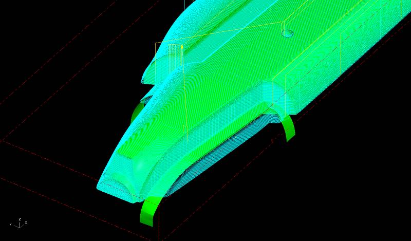

Old 08-03-2007 | 09:26 AM
Posts: 97
Here are some pice of the cad shapes and the toolpaths for cutting the plug. If I get to understand how to load the pics.
Attie

Old 08-03-2007 | 09:44 AM
MHester's Avatar
Posts: 2,707
From: Woodstock, GA
Wow that looks really cool!

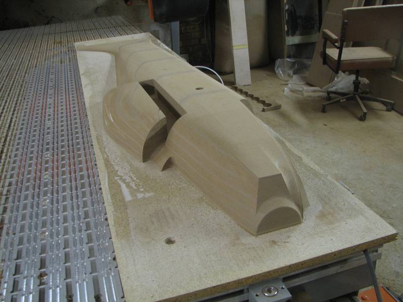

Old 08-08-2007 | 01:22 AM
Posts: 97
Here are som more pics
Attie
Old 08-08-2007 | 01:30 AM
Posts: 97
Sorry lost the pics...
Old 08-08-2007 | 01:32 AM
Posts: 97
again- sorry, will try again

Old 08-08-2007 | 09:59 AM
handglider's Avatar
My Feedback: (23)
Joined: Mar 2005
Posts: 1,097
From: ,
Wow that is just too cool, looks like you've have a slightly different contours around the cowl checks and chin area maybe.
I need to get that cnc machine in my shop, I am sure I can get a second mortgage on the house.
wow....

Old 08-10-2007 | 10:35 AM
Posts: 97
Hi Guys,
We completed the final cut of the plug today. The final shape is really beautifull.
Mike, we tried to include all the mods you posted. Then we looked at all the V3 pics and tried to update our model to V3 from the pics. But that is only a guess. The fuse is now very wide.
We will send you the CAD files if you want it.
Perhaps we can cut you a plug for a couple of V3 kits …..
Here are the pics.
Regards
Attie

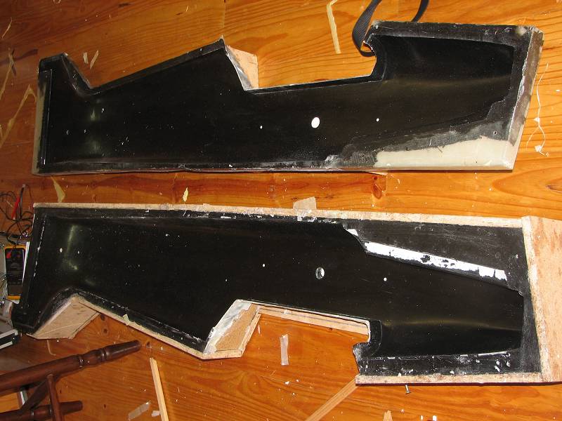

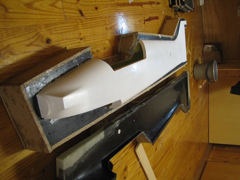

Old 03-30-2009 | 04:17 AM
Posts: 97
OK,
After a long time we got the moulds finished and the 1st model out of the mould.
It is probably a little heavy. It weighs 880 g with the LG block and all bulkheads except the firewall.
Will put some pics on this afternoon.
Regards
Attie
Old 03-30-2009 | 07:26 AM
Posts: 97
Here are some pics
Regards
Attie

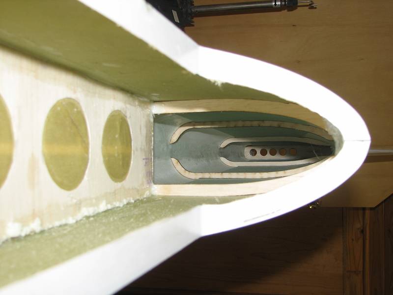

Old 03-30-2009 | 07:31 AM
Posts: 97
Some pics of the internal structure
The ribs are 3mm balsa with light glass on one side. Some kevlar on the 1st bukhead and the sides.
The shells are made of 3 layers of 60g/sqm glass with 1.5mm Herex foam on 60% of the area.
Regards
Attie

Old 03-30-2009 | 11:55 AM
handglider's Avatar
My Feedback: (23)
Joined: Mar 2005
Posts: 1,097
From: ,
Hey Attie...
now that is cool... looks more like a v2.9
looking forward to seeing it finished....
great work... !!!
dean
