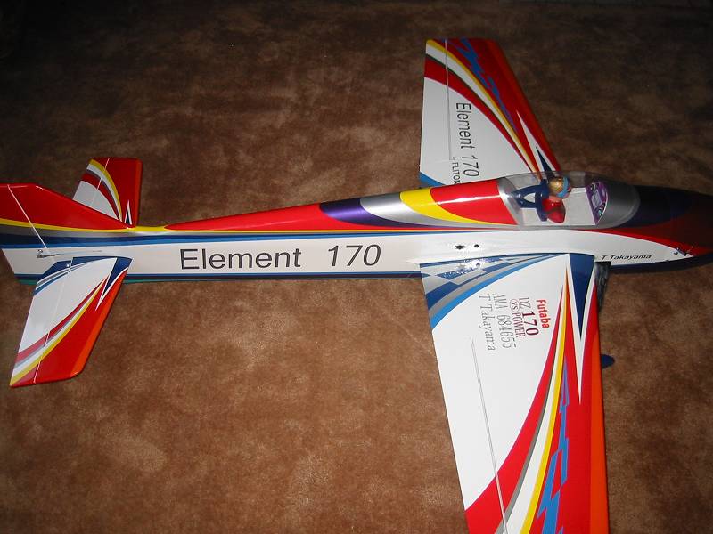

After 10 flights, here is set up my Element so far.
Engine down thrust Cut 2mm for rear mount spacer.
Wing incidence 0 degree.
Stab incidence - 0.3 degrees.
CG 185 from LE
slightly up for Rudder-Elevator mix (No Aileron mix)

Very Nice Job!
How about a performance update?
Waiting on my composite version to get here,...will post an assembly thread and photos.[8D]
