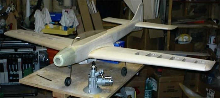

Being flying Dirty Birdy's for several years now in SPA Pattern. My sig pic is a DB. What I've seen is some confusion over the Dirty Birdy and a later design Joe did that allowed the incorporation of a pipe which the Dirty Birdy did not. In any case one of the distinguishing features was the vertical fin LE which is concave in the DB but straight in the later design (I believe it was the UFO but I'm not sure on that). Anyway, I've seen several of these at least one of these at a contest listed as a Dirty Birdy which it is not.
Attached is a pic of an all-wood (not a kit) DB under construction for a friend. It will be using an OS .61 FX or an OS .91 Surpass. HE hasn't made up his mind yet.
No, the big MOKI is NOT going in this airplane! :-)

CurtD,...
I am curious to know where you got the fiberglass cowl for the Dirty Birdy 60 that you are building?? Typically "wood" Dirty Birdy's had wood cowls, EXCEPT for the Dirty Birdy 40 kits which came with glass cowls.
Yes,... my Dirty Birdy is a bit confusing since it has a diferent shape rudder, NO sub fin, as the depth of the fuselage was increased to include the open pipe tunnel.
And yes,... to the best of my knowledge the anhedral stab was a UFO and XLT feature only.

The fiberglass cowling is my own. I made a split mold and can pull a cowl with about 30 min. work. The cowl makes working on the engine a breeze. I side-mount my .91 Surpass and run a 12-11N APC prop which seems just about right.
Your DB appears modified considerably from Joe's original design. The vertical fin and rudder are very different and the lack of subfin makes it look like another design. I would expect that without the subfin there would be considerable roll coupling in knife edge?? I also notice the wingtips are squared off. The original has a sharp edge around the entire wingtip and the same on the stab. Look closely at the tips in my pics. Joe B. says that the wing needs those sharp tips but I've never asked him why.
Sorry, but your DB wouldn't be legal for SPA!!
