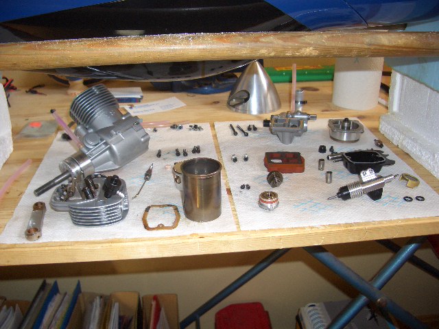

Hi,
The DZ are perfect for pattern , it has the throttel-management what we looking for in pattern ...
Besides, like the pictures shows ; i have my own modifications + enjoy looking after the "jewel" now and then.
Now the lucky owner of the 160DZ is my Integral, running flawlessly with 16,5X12W , hattori-exhaust, CP-30, hyde 140 ARA ...

What are the modifications you're making Kjell?

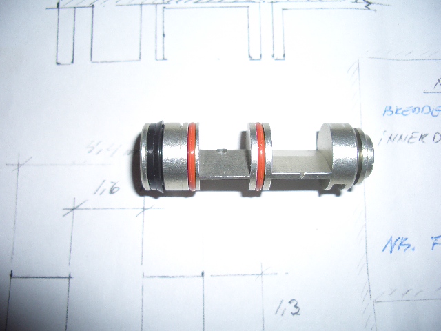

Hi Bla Bla,
... It all started when i got an DZ that would not run properly ... I guess i was unlucky, picking the wrong "YS-lottery- ticket". Besides, i do not even win in a "Cake-lottery", so i was not suprised ...
So, after some testing and research, i found that the Throttel barrel was leaking from the fuel metering-groove straight into the air-intake manifold. In addition, the barrel had leakage from the high press air side to the suction side ...
These parts ( throttel housing/barrel) seems to be critical about tolerances and temperature stability, so i decided to add two additional o-rings to the barrel.
In the Picture you can see the two red o-rings installed. (originally; only the black seal is installed from YS).
Hope this help ..
Kjell Olav

Kjell, that was a very clever fix you came up with! Congratulations on figuring out what the problem was... Most of us would've given up in frustration!
