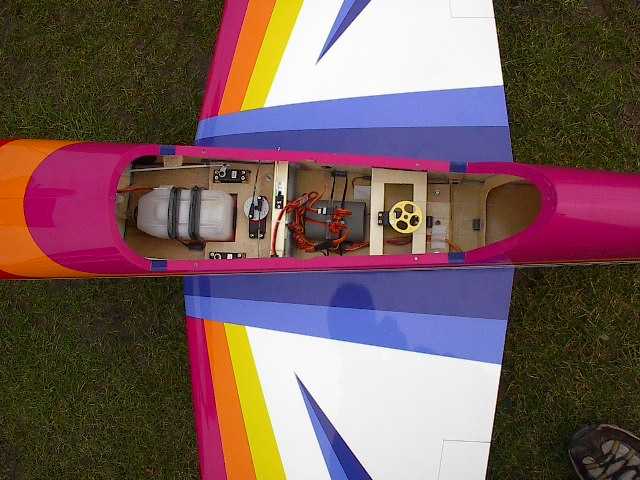

Regarding the fuel tank. The models CG is located 210mm's from the leading edge of the wing measured at the root; where the wing meets the fuselage side. This equates to 52mm's behind the rear edge of the wing tube.
You are correct that the fuel tanks CG is located forward of the models CG. I do this for the following reason: The models CG is measured with an empty fuel tank, and it's NOT a good idea that the models CG is moved backwards when you fill the fuel tank. Therefore I make sure that the fuel tanks CG is forward of the models CG.
I hope this made sense...?
By the way, the root cord of the wing is 475mm's, this means that the models CG is located approx. 44% from the leading edge.
I have attached a picture showing the location of the fuel tank on the designers Rhapsody Competition. His fuel tank is located even further forward...

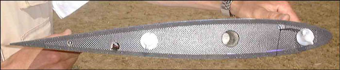

The wing fixing on the PL-Prod planes is done using a nylon screw in the root rib and the nylon "wing" nuts you can see on the picture in my last post. I wondered for a while where they got these nuts, which seem ideal for this purpose, until one of my friends told me that it was toilet seat hold down nuts........... I checked on my own toilet, and he was correct.
I have attached a picture showing the root rib on one of PL-Prods planes. As you can see the screws are spaced evenly on either side of the wing tube.
Yes, I think the 3M-140 would be nice for an Enigma. It should have comparable power to an OS-140RX. Actually I think the 3M-140 is also more than enough for the Rhapsody, but compared to the Synergy I think the Rhapsody is the most power hungry... That is the reason behind my thinking.
I actually have a Dingo in my closet which was meant for the Synergy, but I don't like the fact that you need to run 25%-30% of nitro... It's expensive stuff!!!

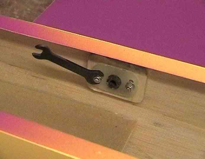

On your wing adjuster. It appears to be at the trailing edge. If so, wouldnt it be better at the leading edge as far as keeping your wing in true trim or does it not matter where this adjuster is located? We have found some 1/4x20 aluminum bolts that are light. It looks like you are using two hold on bolts also.
I would like to use this method on my new ship that I am building.
Wayne
Wayne

Actually the picture above is not of one of my planes, but borrowed from the PL-Prod web-site... I think it's of a Tornado.
The Rhapsody has not been designed to use adjustable incidence, it only has one guidance tap on the root rib. This is made of a 10mm carbon tube.
The attached picture is of my Rhapsody, and it shows the single tap in the root cord.

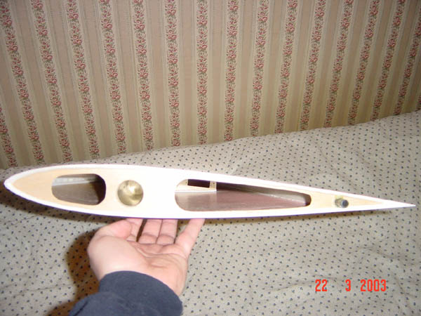

I just remembered that Lorenz actually do sell adjusters for their kits... I haven't bought them, but they are available for 10 Euros.
The attached picture shows the concept.
