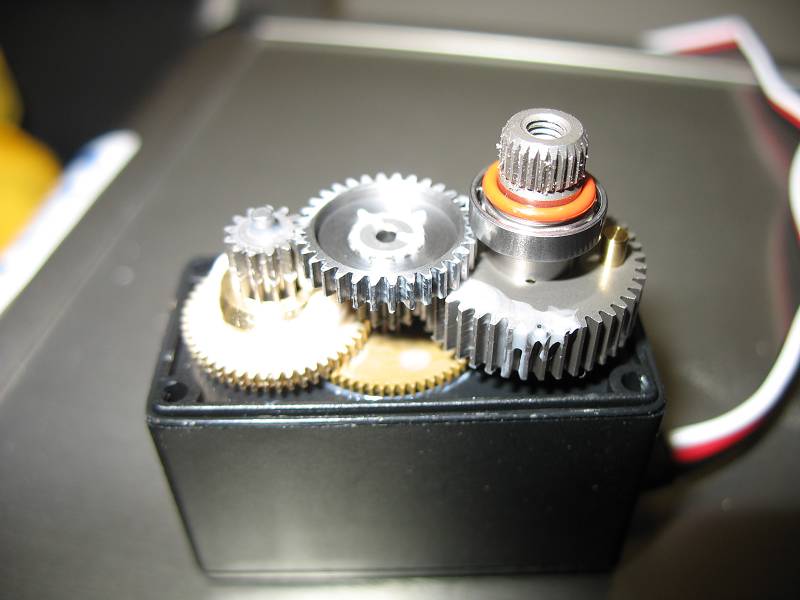

Is this a metal gear servo? How is the play after running awhile in an electric and a YS.

I contacted Futaba support here in RCU, and they told me these servos are metal geared , like many of the todays high level servos.
Personally, i have not so good experience with metal-geared servos and YS ...
Generally; it is not any problem with the motor assy, but the gears and pots ....

i read on Futaba's site that the only one that in the spec talk about metal gear is the Futaba BLS351 Digital High Torque Metal Gear .
The 251 is a gyro servo ..maybe on elevator......and the 451 (that I orderd) has not this in the describsion...
I dont say that you have wrong Kjell.....but this is what i have found!

A picture is worth a 1000 words They look pretty metallic to me!
Brian, I cant speak to running them on glow but there is virtually no change in mine on electric.

In my personal opinion, this is one of the good things using electric powerplant ; they treat the equipment , like the servos nice A widely possebility to choose the hot stuff ...
Since i spend my time with the truly strokers, a will try a different route next time i choose servos for my next future project. A friend of mine, and a very skillfull F3A pilot have tried some cheap digital carbonate-geared JR servos ;and he felt that they was quite ok.

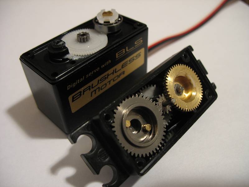

Here is the BLS 351, just came in today. Same super tight geartrain of the BLS 451, but with 217 in-oz @ 0.13s on 6V its stronger and almost as fast. Should make a superb replacement for the 9351, or 9155 on rudder applications.
Again all metal geartrain with the exception of the 1st gear which is nylon with a metallic pinion.
Unfortunately its -20c here and there is a fair bit of snow....so it will be a while before there is a flight report
