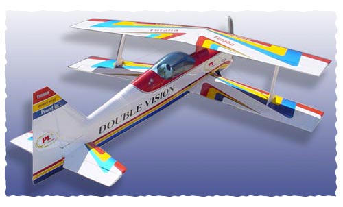

OK.. just got a short note from Chip this morning.. The DV has flown..
Pictures to follow..

Yes.. that is a DA-50R sitting next to the DV here. Chip is putting a DA-50 into another prototype more as a sport airplane, but it's also possible it might make the 11 pound weight limit too. Imagine that kind of power available
Just lettin you know it is by far the most awesome F3A plane I have ever flown hands down.

I just want to let everyone know that it was not ever meant to be a big secret about the plane. All I was worried about was if it didn't work, I didn't want to have to explain the reasons why. I only told some friends about the project, and I did ask them not to mention it for that reason. I do not believe in all that secret squirrel stuff some people do in order to try to win.
Now, about the plane itself. I read were some people compared it to a hyde-out, that is very true. The hydeout was designed as a bi-plane originally in 96, and that is why the canopy was so far back. I didn't feel we had enough horsepower to show the full potencial, so Dave Guerin and I put the project on hold.
The plane as you see it is 2 meters long, and the wings are slightly shorter. It is over 1600 square inches, and as seen in the photos it weighs it weighs 10 pounds 5 oz. That is with a 2400mah Powerflite Battery, the long Hatori pipe, and 23oz Tettra tank with the bag. I could easily get below ten pounds, but I think if anything we may add some weight to it. I only flew it for a short time, but the only trim needed was 1 click down elev., 1 click right rudd. 5% ail to rudd for knife edge, and 3% up elev. to rudd. It went straight up and down, and that was the most important thing to me.
Central will have kits available as soon as possible if anyone is interested. Troy Newman, Donny Wright, and Dave guerin were here for the test flight, and they to would also be glad to answer any Q's.

It looks very good indeed, however, I've never seen a F3Aish bipe fly, and nothing even close to it either, so I cannot really comment on how I expect it to fly, but the looks are definitely on the DV's side. My main 'concern' would be how it handled snaprolls and such maneuvers, but I'm quite confident that you have thought of the same earlier. Good luck!

Looks bloody awesome!!!!!!, great work Chip!!!!
Are you going to soft mount the DA?
What are you going to change to keep the C.G back on the DA powered prototype?

I have read much of your thoughts on biplanes and I agree that the 3D advantage goes to the biplane for stability in high AOA flight making it the ideal 3D paltform.
That said, what are your thoughts on a double vision with enlarged and counter balanced rudder and elevators? Would you want to make geometry changes in the wing and enlarge airlerons too?
I seems to me that the modified F3A bipe might be the ultimate Romilly machine.
The DV looks great. Darn, another airplane I cannot live without.

Very interesting airplane but the low position of the horizontal tail is not all that great looking.
With a low wing only airplane the low position of the tail has shown itself to be an advantage as far as positioning the tail with respect to the downwash.
With a bipe you have downwash from both wings. This means that over a vertical distance of several inches at the fuselage station of the tail the downwash is going to be fairly constant. The horizontal tail could be raised to give a more pleasant look and still retain all the advantages with respect to downwash.
