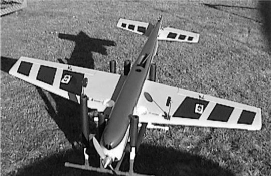

My BeatOn 90 has Cub yellow as base color. Wing bottom has 3 purple parallograms on each side. They are slightly spaced and getting smaller going outside of wing panel.
In your case, yellow type color should be very visible.
Picture below is a greyscale of my plane bottom just to see how color changes when it goes dark.

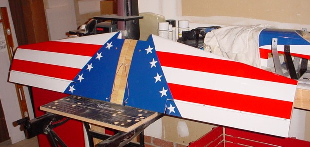

What I normally do is put all my color on the upper surfaces with patterns generally oriented span-wise. I'll typically use 3 or 4 colors with a "base" color of white (although there ultimately is very little white left). Conversely, the bottom is almost completely white with a small number of stripes oriented chord-wise in a single, different contrasting color.
This gives me three opportunities to determine plane orientation in the air:
1. Dominant color (colors on top, white on bottom)
2. Stripe orientation with respect to wing (span-wise on top, chord-wise on bottom)
3. Number of colors (large number on top, single color on bottom)
As an example, here's some pictures of my G-202 wing...the top:

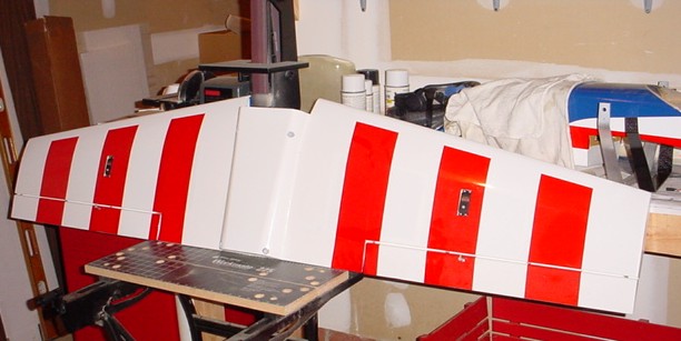

And the bottom...normally I would use a color for the bottom not in the rest of the scheme, but I was running short on covering when I was finishing this bird up.
