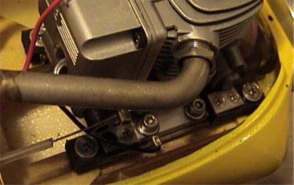

I am assembling mine now.
Mine came with fixed gear. I would not have purchased it if it had retracts that are a pain.
I am installing a Saito-120. I threw away the soft mount that came with the kit. Then added an extra thickness of 1/4 ply over the wood motor mounts to substitute for the soft motor mounts. The Saito-120 fits the width of the wood mounts just perfect
I think the Saito-120 is just slightly heavier than a YS-91 and probably about the same power.

The engine mount if they are same in the FAI version. They are similar to the one from MK, DaveBrown, World Model, Go Model, Super Quality Series of Kyosho etc. Out of these mounts, MK & Go Model are from Japan.
I use Go Model mount in my Beat On 90 because the airframe itself was designed for Go Model mount.
If you guys do not like the engine mount, you may change them with MK ones. World model engine mount.
Just be sure they fits right without changing the thrust line.

Now about the motor mount. I am actually looking forward to trying the included motor mount -the part that bothers me is the wood rails. What is your feeling about them - do they tend to weaken with age. - Is there anything I can do to protect them -other than a good coat of thinned epoxy.

For the engine mount rail. How thick is it? I don't remember how thick it was in my Explorer Acro. I also do not have picture of it.
For reference, I am attaching a few pictures of my Beat On engine mount. The rail is 3-ply aircraft plywood under the actual mount. (about 10mm thick)
Additional ply-wood in the front end and rear of the mount for installation of the engine mount.
Let me know if this can help. If not, I will try to take a few more pictures. (My Explorer is behind a whole room full of boxes.)

Thanks for the pics. Iassume you've not had any trouble with the motor mounts or you wouldn;t have 'em on the Beat on :-)
GlowPlugBoy - I don't have any experience with these mounts but it looks good. My local pattern guru said they're good and if Patternflyer is using a very similar mount -hey that's good enough for me. Certainly not gonna pay the price for a hyde mount if before I try these out.
