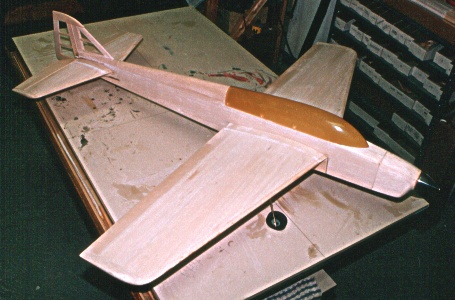

In my original message I mentioned that I was building a Joe Bridi Great Escape with an inverted mounted 91 Surpass. A few other modifications that I've made include building up a full trutle deck after the fiberglass canopy.
Also,.. I'm using a conventional tail dragger setup with retracts. These alterations have produced a very up-to-date modern looking pattern plane.
In these pictures, with radio gear installed, the plane weighs in at six pounds six ounces. I truly believe the finished ready to fly weight will be less than seven pounds!!

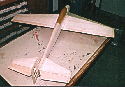

Here is another view of my GE.
Please feel free to contact me if you have any questions or need additional convincing to pursue a project like this for yourself!!

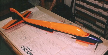

I just finished covering the fuselage to my Great Escape. And as some of you asked for a picture or two as the project continues I'm posting this photo of the completed fuselage.
Now I'm feverishly trying to get the wing covered for the first pattern contest of the season in District 1.
